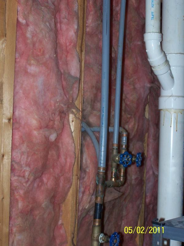

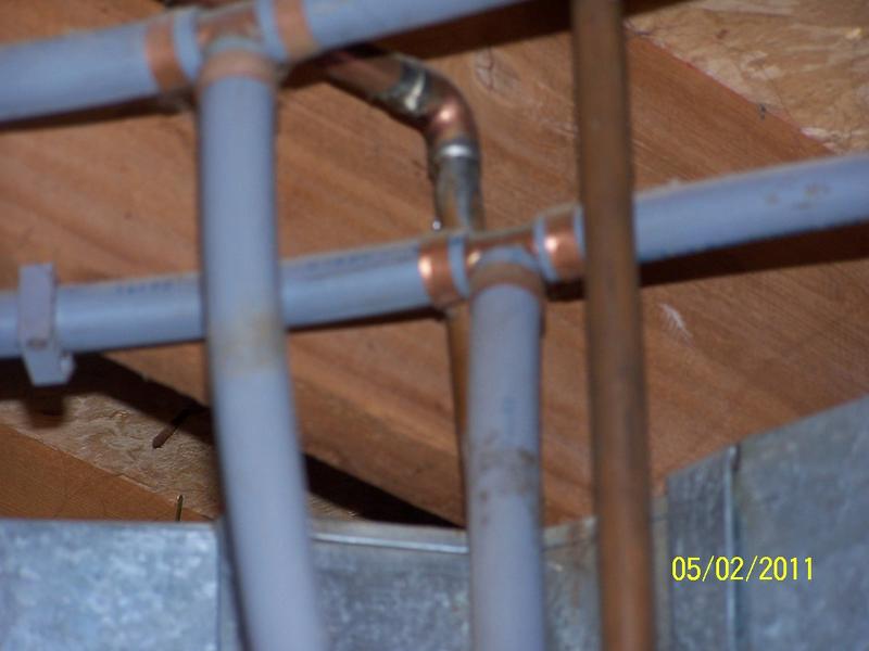

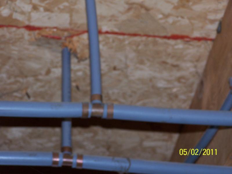

Thanks to all who chimed in here. I forgot a few pics.
Jim
Yep, that’s PB.
