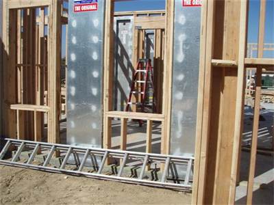

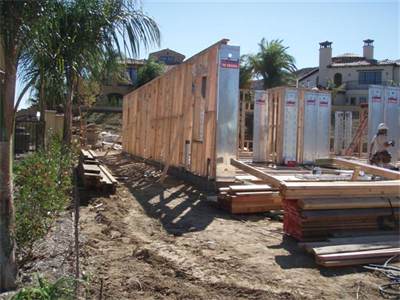

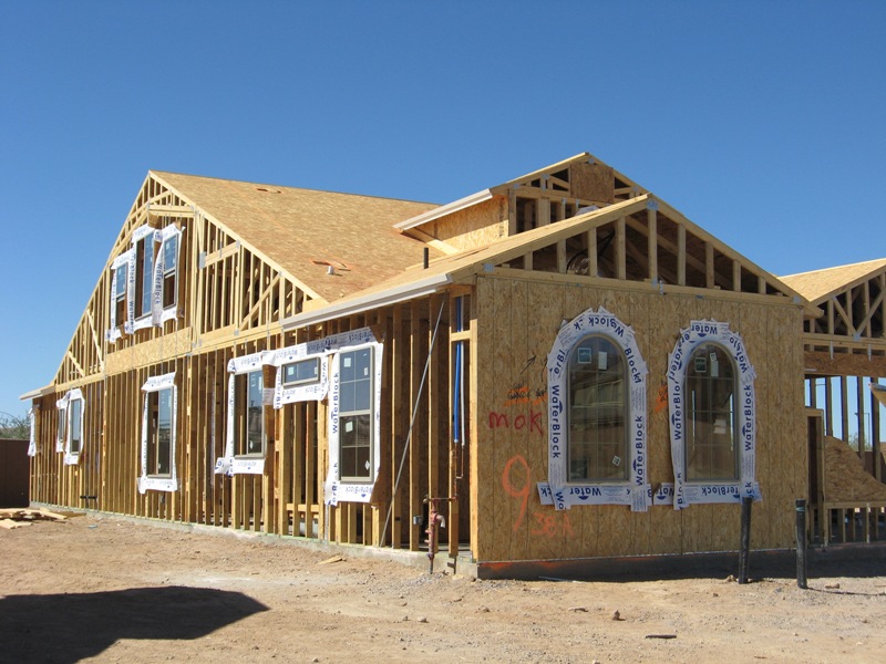

While I am talking to the structure experts let me ask this. What determines where they put the siding on the vertical walls. I watch a lot of homes being built and I can find no rhyme or reason to where the chip board is added and where it isn't. I would like to see a set of plans that the framers use but so far I haven't had the chance.
(Jeffrey R. Pope, CMI) #11
Generally, it has to do with the required shear-strength (the design strength) of the wall. Sometimes it’s paneling (as you have pictured), and other times it will be steel panels or “strong-walls.”
(Gary Heller) #12
I haven't seen the steel. Is it common to see some walls with no panels? Here in AZ I have seen the same model, one house facing north and the other facing south with the chip board on different walls. Prevailing winds???
(Jeffrey R. Pope, CMI) #13
Possibly. It's all a matter of "design criteria" in your area. Most of CA is in SDC 1 and SDC 2 (Seismic Design Category), so these steel panels are common. AZ's designs are (I'm sure) different from ours.
Where the wall dimensions limit the amount of lumber that can be used to obtain the required strength, these strong walls are the substitute.
