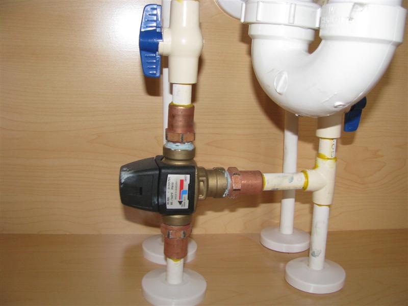

Looking for identification and purpose of this valve located bathroom vanity sink 2nd floor.
Recirculation pump for the hot water.
Agreed
Where is the wire?:)
That more closely resembles a tempering or mixing valve to prevent scalds at the Hot water supply to that fixture. It may be a Sorel (German?) ESBE model. It does appear to be supplying the tempered water in the down direction which does not make sense. I know these are used on radiant floor heat as well.
Boy, I sure messed that one up:roll:
No electric, Doh!
Never seen one, cool. The down flow is confusing though.
Yes, based on the arrows on the label, it looks like a mixing valve with expensive pipe adapters.
