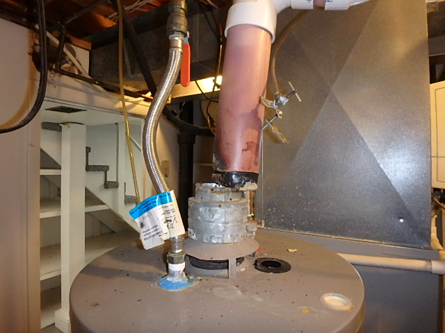

I have been playing this game for 20 years. I have never seen PVC used for venting a water heater.PB182155
It doesn’t look like it held up very well does it?
Interesting article regarding this.
The Lowes Braided Flex line with attached tag is the clue to Harry Homeowner and bud’s installation prowess. The PVC is seeing it done on HGTV without understanding the WHY…!!!
Depends on the efficiency or design of heater
Standard efficiency water heater that flue pipe needs to be metal.

International Code Council’s International Fuel Gas Code 503.4.1.1:
Plastic pipe and fittings used to vent appliances shall be installed in accordance with the appliance manufacturer’s installation instructions.

A PVC Vent pipe does not a High Efficiency Water Heater make…
So is that pipe Pink, or more along the lines of Fuchsia?
LOL. I’m going with charred ivory.
