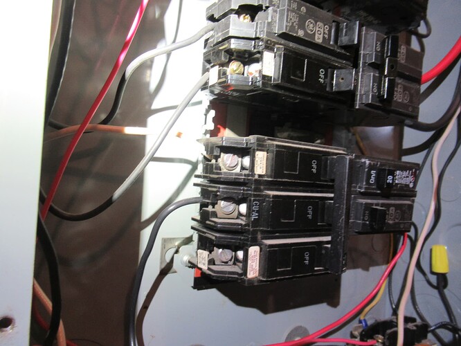

A somewhat related issue. Is there a concern with only two poles being used on this 3-pole CB? Does the CB need to be rated for this? What other considerations? Thanks.
Bottom left
No issue. Is this a 3 phase panel or did they wire it as only single phase?

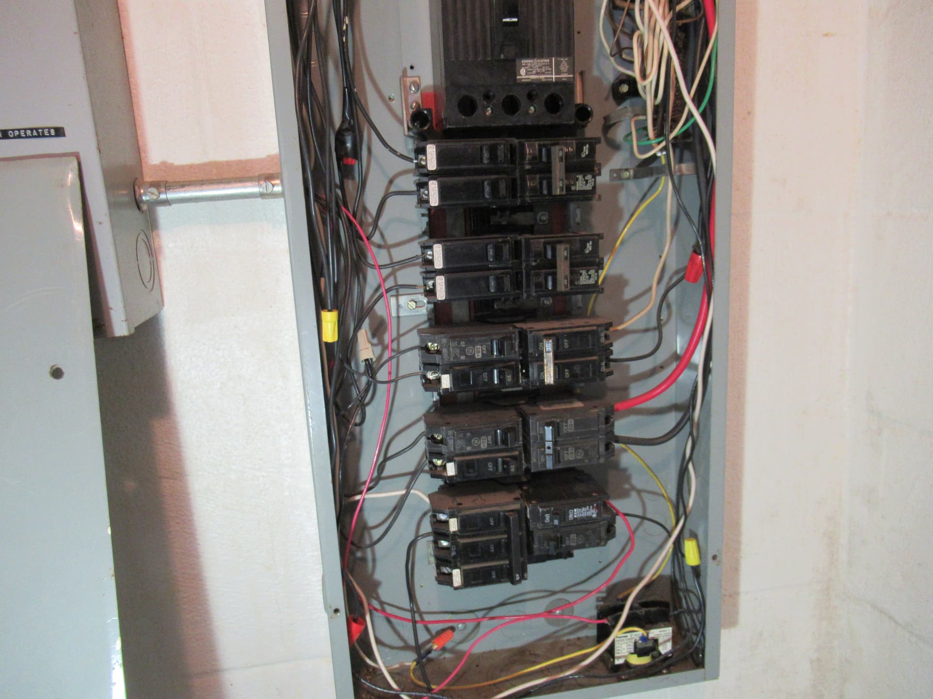

Ha, let me introduce you to my next-level situation. I am unable to determine all the voltages or phases conclusively. Possibly a delta system where they either eliminated or avoided the high leg (which was not identified or labeled as such). Here is what I have. I do NOT use clamp meters etc. It’s all visual. (I was so cramped in this room I was unable to get one good full photo)
Any insight appreciated.
What a mess. It does appear to be a 3 phase, 4-wire Delta service. You would need to take voltage measurements to accurately determine what it is.

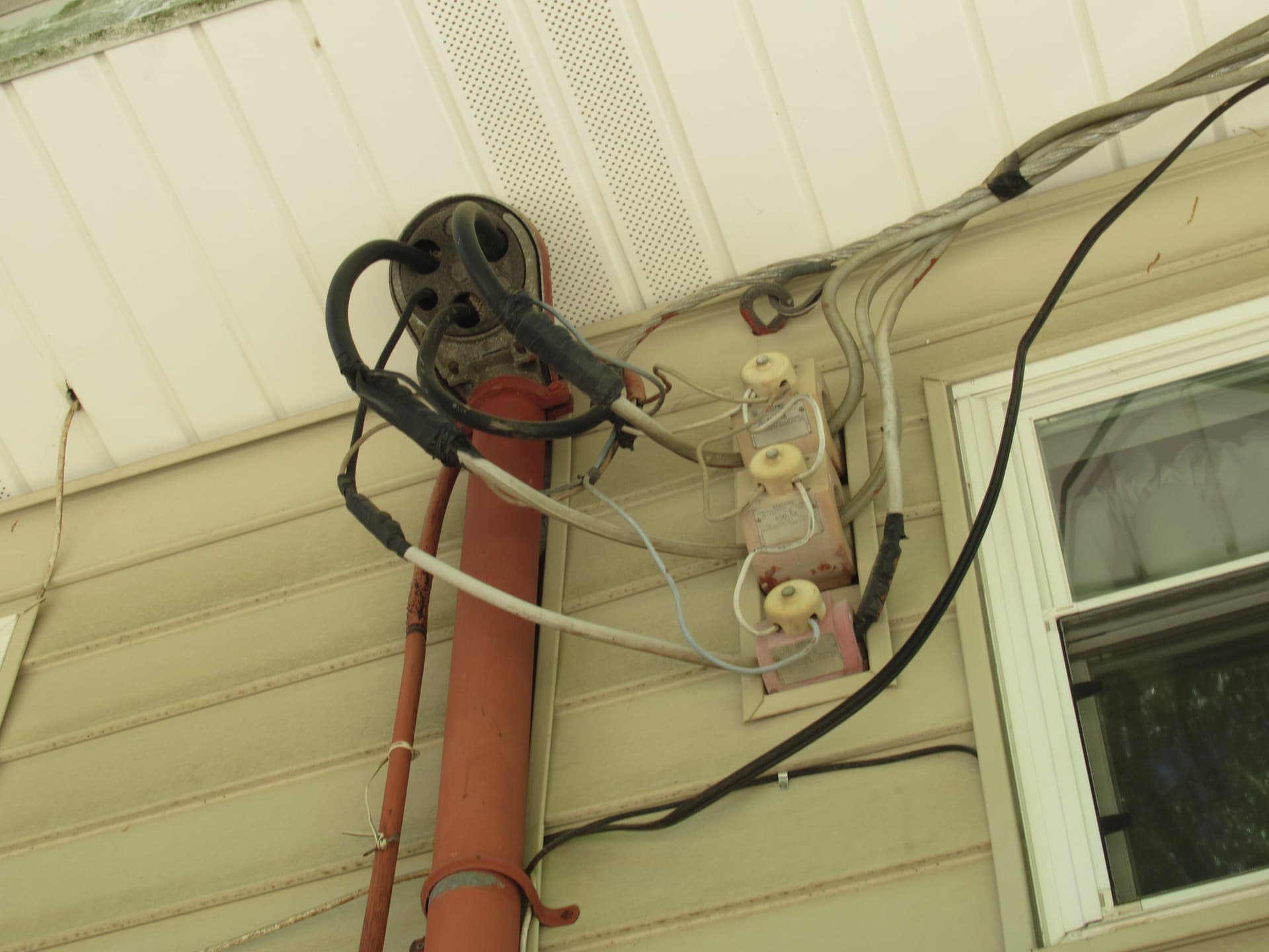

The next time you see an overhead service that you want to identify, try getting pictures of the transformer connections from a few different angles. It’s easy to identify the configuration by looking at the connections.

I have a photo, but I fear it lacks the digital clarity needed.
I can’t see much in the picture. I can only see two transformers. Were there three? An open Delta only uses two transformers instead of three. An open Delta can still provide three-phase power, but at a reduced capacity. One benefit of Delta connections that I hadn’t previously mentioned is that a Delta three-phase system can continue to function at a reduced capacity if one transformer fails or is removed.
I am not 100% sure if it were two or three? I am leaning towards two from memory. I find a good bit of Delta systems in this area of AL, notably older properties such as this. This unlike my home base in Atlanta where I seldom see it.
That’s consistent with what I would expect. Delta systems were more popular in the past than they are now. They were also more popular in rural areas than in urban areas.
Utility companies might offer an Open Delta option in lieu of a smaller closed Delta because they buy standard 25kVA single-phase transformers in large enough quantities that the cost per kVA is probably less than buying smaller quantities of smaller transformers. When I had my electrical contracting business, it cost me less for 200A panels than for 125A or 150A because I’d buy the panels in large enough quantities that they cost less for each panel than the smaller panels. I can’t say with any certainty that that is why open Deltas may be popular in a particular area, but that’s my best guess.
Open Deltas present some challenges where single-phase is also needed though. Another transformer with a wye secondary could be placed downstream in order to derive a neutral. The pole mounted transformers might be owned by the utility company while the downstream transformer might be owned by the customer. That’s a fairly common thing to do. That could account for the lack of a high leg, but you probably would have seen the transformer while you were there. It could be a dry-type transformer hanging on a wall somewhere. It is possible to center-tap one of the two pole mounted transformers to create a neutral, but then there would be a high-leg. Another, but unlikely, option would be a corner grounded Open Delta. That wouldn’t be practical though.
Another possibility to consider is that two standard 25kVA transformers can be connected to create one 50kVA supply. In that case, you would see the tap between the secondaries of the two transformers. Here again, that might make more sense economically than a single 50kVA transformer for several reasons. One reason is that as transformers go up in size the cost per kVA goes up fast. A 50kVA transformer could cost three or four times what two 25kVA transformers cost. If a single transformer fails, another relatively low cost transformer can replace it.
