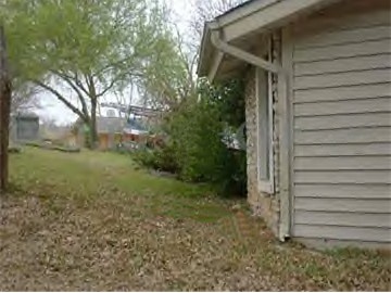

Wow, when I posted my vote it was a dead heat, 50% and 50%, between two answers.
This is going to be a close one.

Why didn’t they just make a cricket?

“the grade away from foundation walls shall fall a minimum of 6 inches (152mm) within the first 10 feet (3048mm)”
It is fair to say that your local milage may vary, but that if you are looking at passing a national exam, this is the "best practice" answer.

Mike, typical American, you could not possibly play cricket on that grade, and the tree would get in the way of the stumps (Jeeez, have I got to tell you guy's everything) ![icon_lol.gif](upload://zEgbBCXRskkCTwEux7Bi20ZySza.gif) ![icon_lol.gif](upload://zEgbBCXRskkCTwEux7Bi20ZySza.gif) ![icon_lol.gif](upload://zEgbBCXRskkCTwEux7Bi20ZySza.gif)

OK, so what do we do when the houses are closer together than 10 feet.

Where lot lines, walls, slopes or other physical barriers prohibit 6 inches (152mm) of fall within 10 feet (3048mm), drains or swales shall be provided to ensure drainage away from the structure.

That’s what I was looking for. Thanks Gerry.
