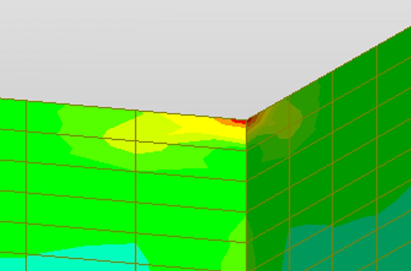

Does your foundation corner look like the first two attached photos?
If, so this is caused by expansion of the brick veneer. Brick expands due to heat and/or moisture but the concrete foundation doesn’t expand as much. This difference builds up stress in the concrete foundation because the brick is basically glued to the foundation with mortar. I ran a computer simulation (third picture) which shows the stress build up at the corner of the concrete foundation shown in red. Concrete typically can withstand a large load in compression, for example 3000 psi. However concrete is weak in tension, typically the tension strength is only 10% of the compression strength. So in this example 300 psi, which is why the corner of the foundation is easily broke off by the forces induced by the brick expansion.
