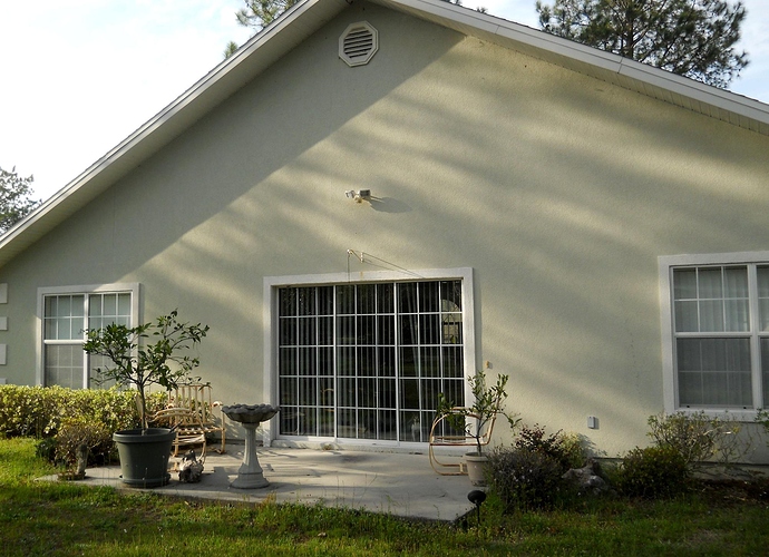

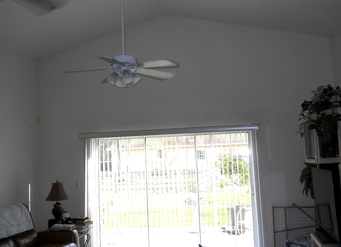

it gives better wind resistance on a gable roof.you will usually find balloon framing which means continuous lumber from the bottom plate to the top plate usually found in Cathedral or vaulted ceilings.Gable end roof drop trusses are usually allowed where applicable.however,if the vaulted ceiling terminates flat on a Gable end balloon framing is required. at least in Florida it is.

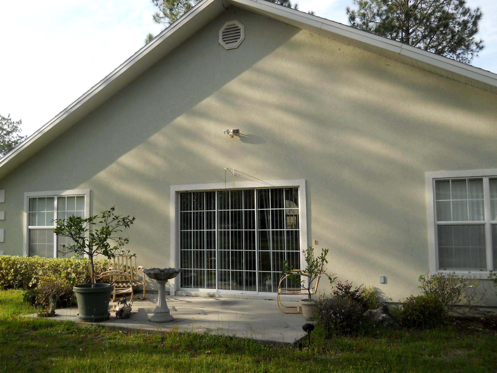

You have to look at it in a engineering perspective.
Lets look at this example.
B1 is the interior vaulted ceiling. No way to put a drop truss there. B2 is the exterior view.
For proper uplift protection on this gable end it would have to be baloon farming.
Why? Because there is nowhere to put a gable end drop truss.
Agree?
Send me the books…
Sorry for the large pic…

Roy your photo is a poor excuse for a balloon framing example.
That cathedral ceiling could have been created using a scissor truss with the proper lateral bracing and tie down hardware for the extended wall studs to the truss.

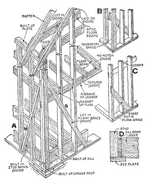

This is balloon framing.
Balloon framing has several disadvantages as a construction method:
The creation of a path for fire to readily travel from floor to floor. This is mitigated with the use of firestops, now called fireblocks, at each floor level.
The lack of a working platform for work on upper floors. Whereas workers can readily reach the top of the walls being erected with platform framing, balloon construction requires scaffolding to reach the tops of the walls (which are often two or three stories above the working platform).
The requirement for long framing members.
In certain larger buildings, a noticeable down-slope of floors towards central walls, caused by the differential shrinkage of the wood-framing members at the perimeter versus central walls.
Larger balloon-framed buildings will have central bearing walls which are actually platform framed and thus will have horizontal sill and top plates at each floor level, plus the intervening floor joists, at these central walls.
Wood will shrink much more across its grain than along the grain. Therefore, the cumulative shrinkage in the center of such a building is considerably more than the shrinkage at the perimeter where there are many fewer horizontal members.
This problem, unlike the first three, takes time to develop and become noticeable.
Present-day balloon framing buildings often have higher heating costs, due to the lack of insulation separating a room from its exterior walls. However, this can be remedied through the addition of insulation, as with any other framed building.
