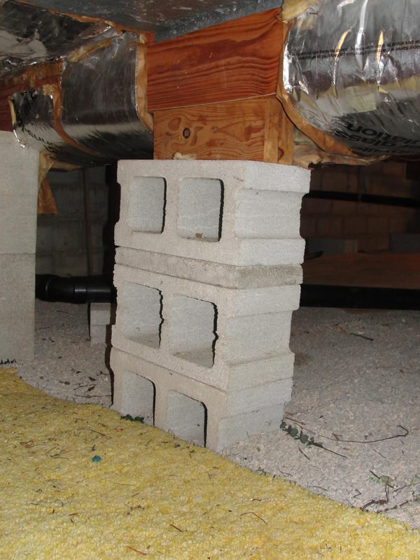

Realtor says been this way 30 years. Im looking for something in writing to show this is not correct.
Any help is appreciated.

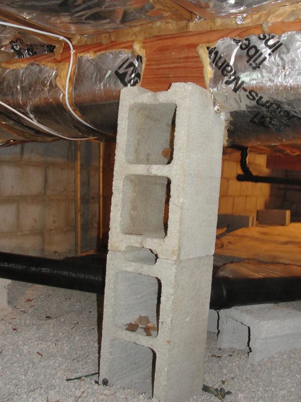

For one, the blocks are not stacked correctly. The ‘hollow’ should be going up and down, not front to back. That should get you started.
anyone have IRC stating this is wrong?
NACHI education course covers it well.I believe the structural course. It has been a good reference guide for me. And it’s included in membership. : )
There are so many things you could put but simply advise your client that the piers (and possibly the footings) were not constructed in regards to acceptable building practices and possibly local / state codes, ie. (insert improper or lack of footings, improper installation of C.M.U.'s, no mortar to give structural stability, etc) Recommend that a licensed General Contractor do a detailed inspection of the foundation and make necessary corrections.

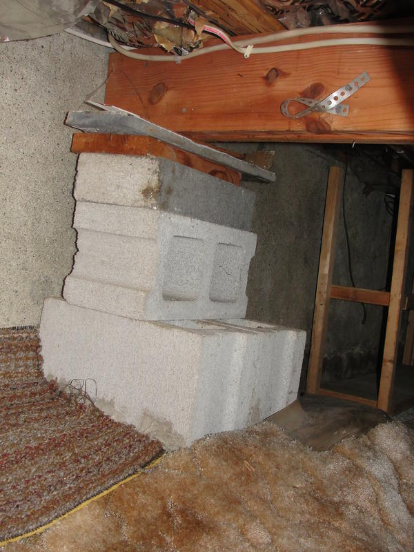

If I get a chance, I will be glad to send you some pictures of a home I inspected today as a GC to offer up an estimate for my clients…their foundation also was built similar (dry stack, improper installation of CMU’s, no footer, improper girder sizes, etc)…yet they will be forking about over $10,000 for me to come fix it.

forget code they are not installed to the manufactures specs. Recommend a structural engineer to devlope a scope of work for repairs

Typical response from some realtors. It may have been this way for 30 yrs and so far no noticeable deflection in the intermediate floor components. This does not change the fact that defects were discovered with the structural supporting columns and they should be evaluated by a structural engineer who may require repairs and discover further defects because it is a non-typical installation.
I would defer to an engineer for further evaluation and course of action. A contractor created this mess in the first place and might think it is just fine.
In CA this is an easy call - tear it out and start over.
For those of you in the more boring states (;)) that don’t shake occasionally, start with IRC 606.5.
You don’t need an engineer, just a qualified contractor.
IRC 2003 606.5 When used to support beams or girders…where hollow, masonry units are solidly filled with concrete or Type M, S or N mortar.
A qualified contractor in my area would be Bubba with a shovel and some ready mix concrete.

Steve, it’s not a code issue, it’s a framing quality issue. It’s a matter of what was acceptable framing practices when this home was built. This was never acceptable framing practice.
The realtor is probably right. It could easily have been this way for 30 years and might hold up for another 30… or maybe not, but the realtor is wrong… it’s not “OK”. It’s an unacceptable framing practice and may fail catastrophically. Recommend correction by a qualified contractor designed by an SE if you think appropriate and move on.
