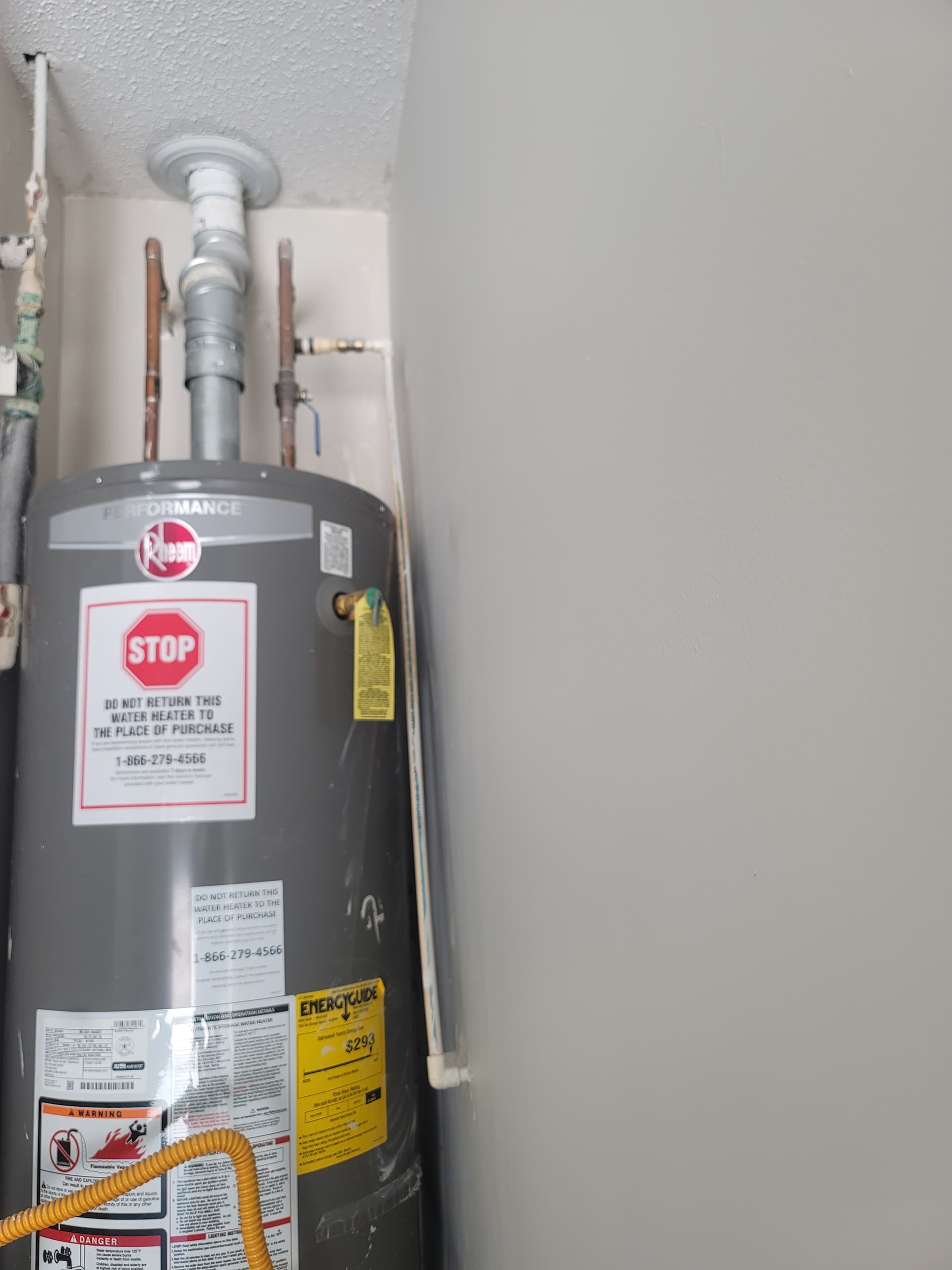

I have been seeing these regulators replace expansion tanks in newer homes but never with a drain pipe. Additionally, there’s no drain pipe on the TPRV. Is this right?

Are you sure that’s not a thermal expansion valve? It looks like a adjustable relief valve.

GA follows 2018 IPC, which states the following:
So a tank or device shall be installed…but be sure to see when they are needed and if you were able to confirm this requirement. Go gently into the abyss.
TPRV drain pipe. I have never seen the drain pipe “not be required” along with many other drain pipe requirements.
I do believe the calibrated pressure relief valve may be used. If this is in fact what has been installed in the OP’s photograph I do believe it is correct.
Right, tank or device is the way I understand it and was the intention of my post. I believe many inspectors are looking for tanks only and miss the device which gets them in trouble.
Furthermore, in my state tanks/devices are required on closed systems, which is nearly impossible to verify.
I agree I see a lot of thermal expansion valves but I have never seen a calibrated pressure relief valve. This forum can have some valuable information.
New construction I am seeing more and more of this; relief device connected to the TPRV drain pipe. I see no accommodation for this anywhere in code. Must be a local thing or just wrong. I mark it as wrong.
I see this quite a bit too. I call out the tee that has been installed in the pressure relief valve discharge piping and ask that the thermal expansion valve be ran separate.

Yes, looks like an adjustable pressure relief, probably for the whole house. I see those on all new builds here, typically at the exterior, but occasionally on the water heater.
