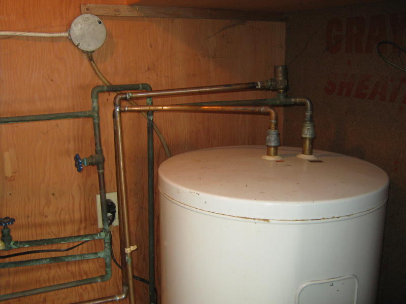

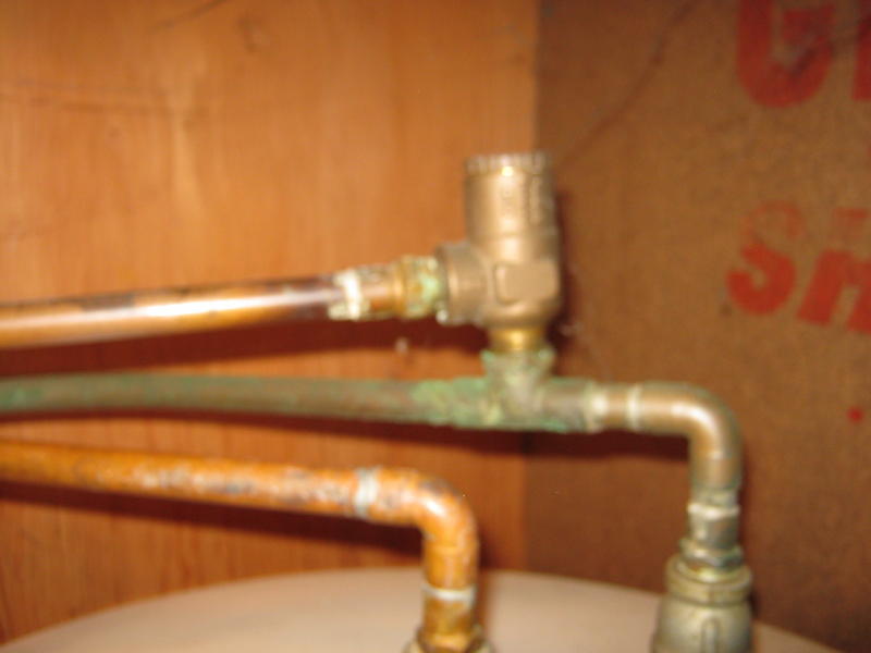

Relief valve
Is this a relief valve on the cold water line? Can you install on cold water line? No other relief valve on heater casing. Any help would be appreciated. This was an “older” water heater.
Thanks in advance.
Yes and it is OK on the cold line as the pressure is the same.
However it is not a temperature sensing device so a TPR is still required.
Exactly what I was looking for, you da man. Thank you. Have a great weekend!

no you dont put a relief valve on the cold water side it goes on the hot side because of the heated pressure
The pressure is the same on both sides.
Riddle me this then.
Why are expansion tanks only installed on the cold side ?
No because it is code or manufacturer instructions as an answer ,please.
If you have a watt-210 valve the pressure relif valve goes on the COLD side on the exterior hose bib. Pressure is pressure equal on both hot and cold.
When water is heated it expands. On a ‘closed’ system the expansion tank, on the cold side, absorbs that extra expansion . If you did not have an expansion tank the pressure relief valve would open
Chuck
The bladder will last longer on the cold side.
