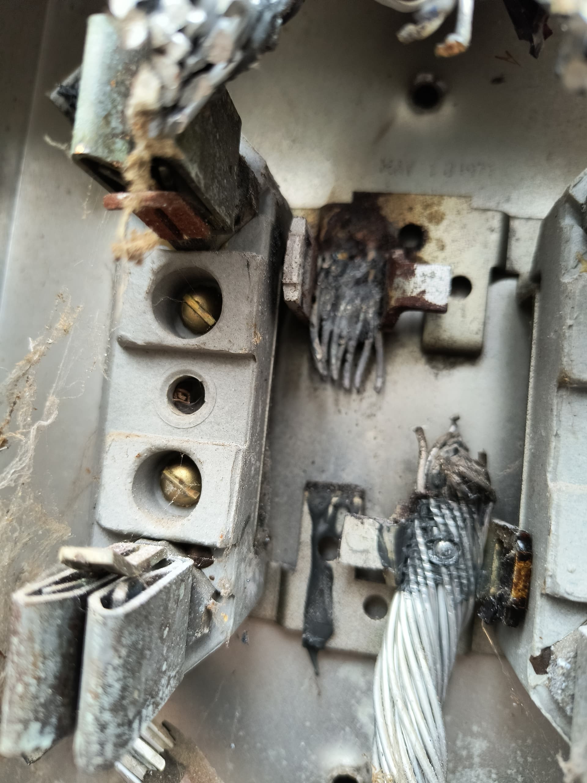

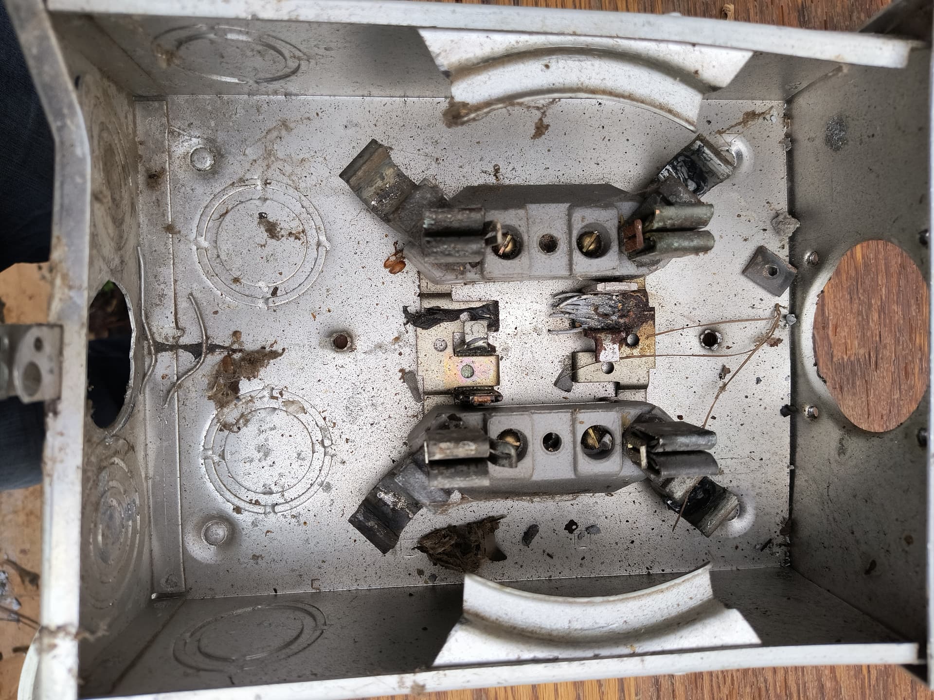

Replacing my meter due to fire hazard
A little rust and a lot of heat. Lesson here, don’t ignore flickering or dimming lights.

Looks like your meter is located inside the home. Are you going with a smart meter or do you have the option to opt out?

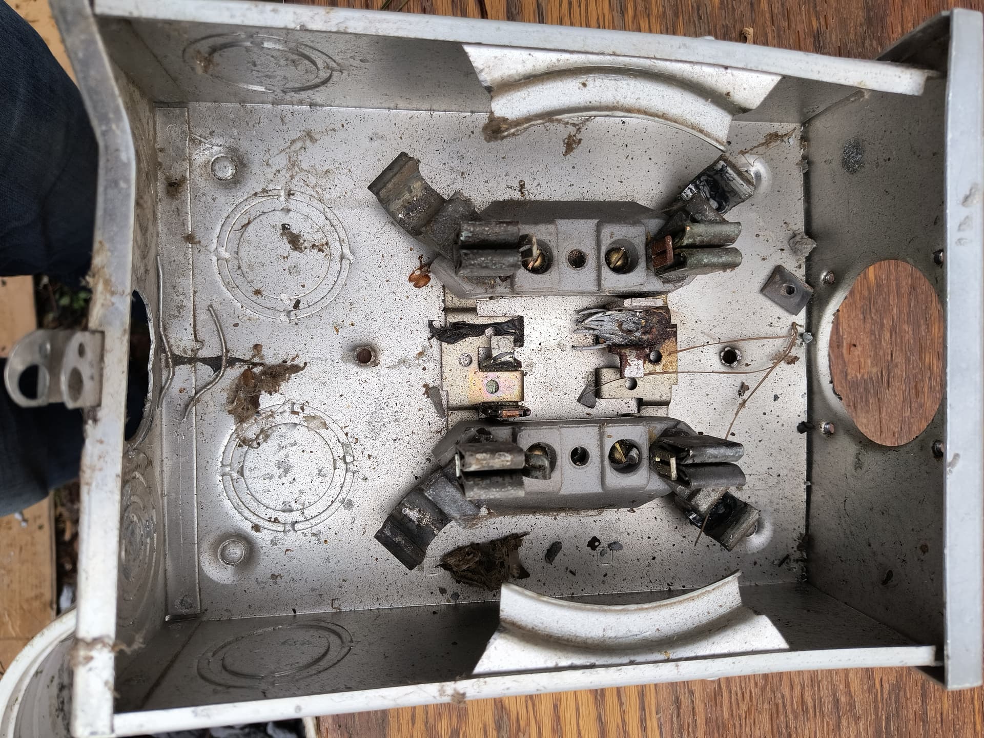

It’s outside. When I took the photo, the damaged meter had been removed and placed on the workbench.

Interesting. As you can see, my issue was also at the neutral connection in the meter can. Side note, you could hear it buzzing.

Where was the issue, Brian? Load side or line side.
Which makes the case for AFCIs. :+1:
And combo CAFCIs that would detect an arc across a conductor break/gap.
Line side.
In this case AFCI’s wouldn’t help because the problem is upstream from the AFCI device.
I believe the number one reason for lights and power flickering in a home is a loose neutral connection. Maybe Robert could verify.
My previous home would flicker all the lights with the agitator on the washing machine. I checked neutral wiring in the panel, at the washing machine, couldnt figure it out. Had an electrician come out, and it was a loose connection at the service neutral at the pole on the edge of my property.
As soon as he replaced the splice, it was fine.
