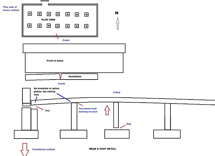

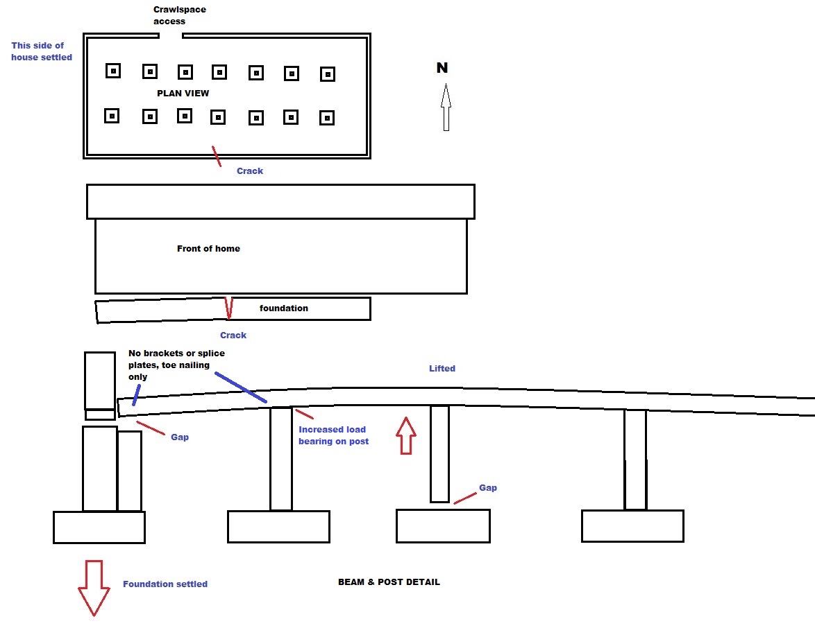

Hi,
This text and the photos were taken from an inspection I performed two weeks ago. This is a common example of my work:
Structure.
A combination of factors have led to the conclusion that the home is settling unevenly and damage has occurred to support structure.
a) Foundation blocks on west side of home are uneven and mortar is damaged. It is probable that these blocks are not filled with mortar or reinforcing.
b) The sill plate on the west foundation wall has lifted off the wall. No visible anchors securing the sill plate to the foundation wall was noted.
c) Posts along the west wall and resting directly on the footing have lost contact with their respective beams.
d) Posts in mid home locations have lifted off their concrete piers
e) A crack was noted on the south foundation wall opposite the crawlspace access.
f) The brick veneer on the front of the home has vertical cracks.
g) Floors have some “humping” in various locations and are generally uneven.
These findings suggest that the west and portions of the north and south walls have settled, causing a crack on the south wall. The wood structure of the home on the west end has “lifted” off the west wall and the wood posts along it. This is putting pressure on the wood posts that are on piers nearest the wall and has lifted the beams off wood posts near the mid point under home. The lack of proper anchors to the sill plates and metal splice plates tying posts to the beams have contributed to this condition. There is an exceptional amount of load on the posts and pier blocks nearest the west wall.
Please refer to graphic and to photos.
Recommended actions:
A structural engineer is strongly recommended to evaluate and estimate repairs
Thanks,
joe Pruitt #977

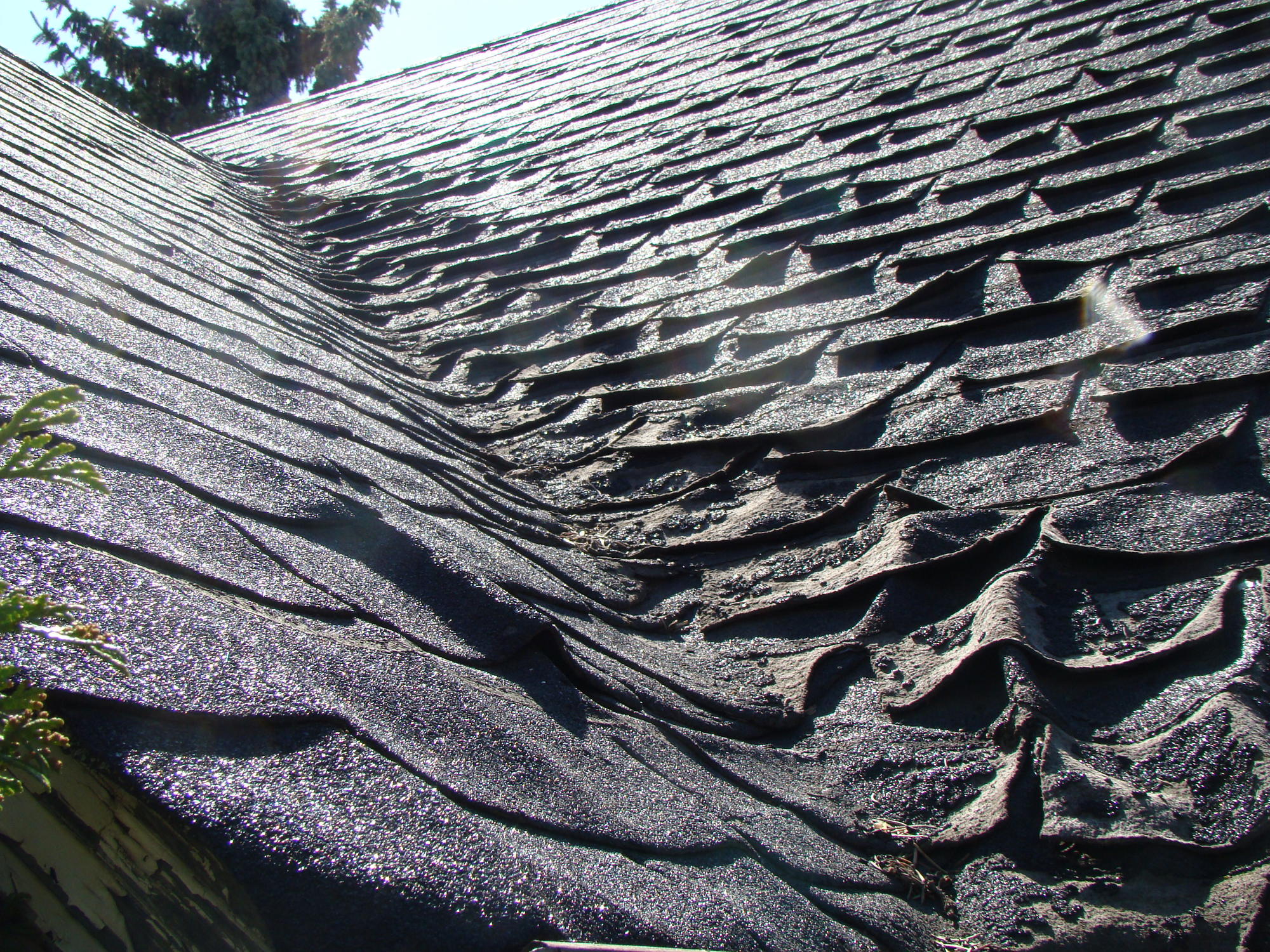

Shingles showing typical wear for age. Most shingles are extremely curled and damaged. Recommend a qualified contractor to assess and repair all the shingles as needed to avoid further damage and water infiltration.

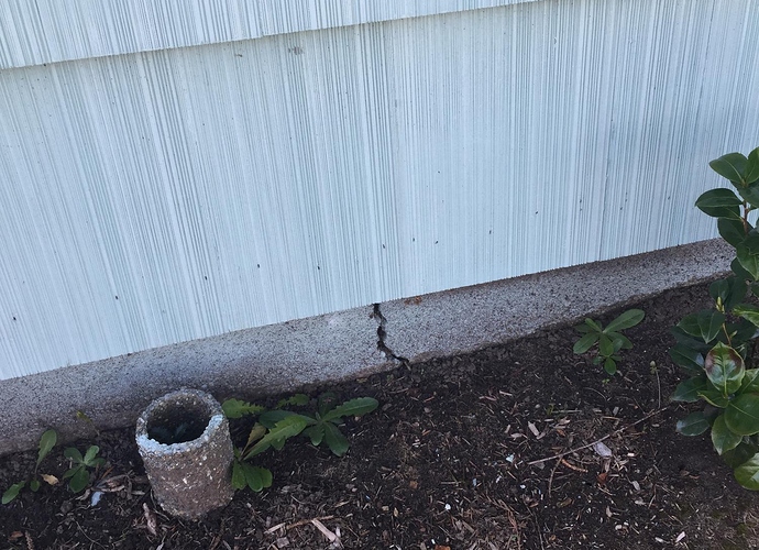

The image above is showing minor settling cracks in the vicinity of an original concrete subterranean storm drain line. These older aggregate concrete storm lines are notorious for clogging and backing up, and or stop working indefinitely. This settling crack is most likely caused by an extreme amount of moisture that has over saturated the soil in the general area. This is a common occurrence I see on a day to day basis. Homeowners need to be informed the importance of routing all roof water run off away from the home foundation.

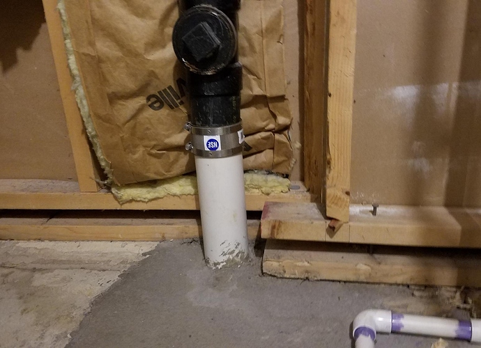

The attached image shows proper and incorrect techniques to basement framing. The wall is properly floating with 10d spikes to allow basement slab movement but the bottom sole plate is not pressure treated which is needed when there is a direct concrete wood connection.

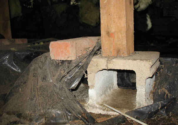

This photo shows a defective pier base in a crawlspace.
The hollow concrete/”cinder” block is used incorrectly. It is used as a pier base, is orientated incorrectly, and is not filled with grout. The pier is placed above the void which is the weakest point on the block
Hollow blocks should not be used on their sides, but should be placed to orientate their voids vertically and the hollows should be filled with concrete, mortar or grout.
It is recommended that this hollow block be replaced either by a pre-cast block or by concrete, cast in-situ.
