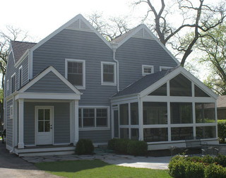

I’m having trouble envisioning it Leonard. I tried Googling “M configured truss” but didn’t get anything that sounds like what you’re talking about. Do you have a picture of one?
Just to add a bit…trusses are designed to bear on all designated bearing points in the engineered drawings. There may be interior bearing points too, but not often. The non-load bearing interior partitions are not to provide any bearing to the truss. It is not allowed to set the partition wall directly under the truss without at least 1/4" gap for deflection.
Sorry Kenton,
Not a roofer so my terminology may confuse. I’ve heard them called double A (AA) trusses as well as parallel gables. I’m not sure if there is a proper technical term for them. To me they just look like a big M.
The problem I’ve always seen is they have a dead valley in the centre, which is a B1tch for drainage and flashing and a collection point for detritus from trees etc.
Anyway, they are built using two truss sets running parallel that require a supporting wall in the centre (not an external wall at both ends). The supporting wall does not necessarily meet the centre line of the two either. Hence my comments.
Here’s a photo.
