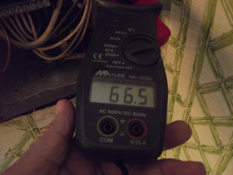

My thought pattern has been based on a 80% load factor as what not to exceed don’t know if I read that or some sparky told me that but in any event I have never had it disputed in a report perhaps the electricans around here just agreed with me so they could upgrade the panel. I struggle with the idea that a panel main is allowed to exceed up to 133% of rated capacity for 2 hours to me that is crazy. But if its so stated in the NEC I will have to except.
That pretty much means no inspector could really ever confirm a problem like this. It’s way outside the SOP but now if you found a load which exceeded the main breaker do you refer it to an electrician or just ignore it?
No I don’t ignore it, I have always refered to the electrican and will in the future. I started checking amp draw on the panel when I started performing IR on the panels checking for loose connections:D

I don’t normally check the draw on the service, but I do check individual circuits when I find things like this…

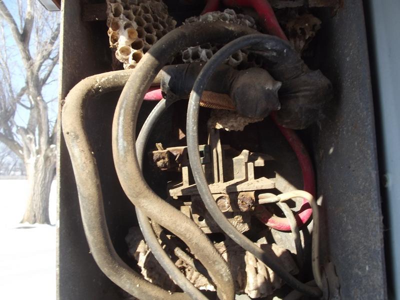

I had one today that was right up your alley first time I have found this make and model in Okla 1952 original The nasty mess was at the pole and meter base feeding underground to the panel in the converted garage

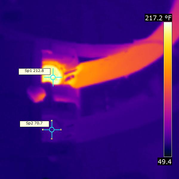

So are you saying as home inspectors we should not care if there are loose connections or are we suppose to use just a little spot gun that takes 15 minutes to go over every breaker. I get the distinct impression that you are not a believer in IR
I am a very big believer of IR when it is done and interpreted properly. I see nothing wrong with using a meter as long as the person using the meter knows how to interpret what they are seeing properly.
I do see something wrong when someone is using these items that has no clue of what they are doing or using them as some sort of theatrical demonstration to show that they have found something they haven’t.
You have made several remarks in the past that just gave me the feeling you were not a fan of IR and beside I felt like a argument with a contractor today so tag you were it;-)

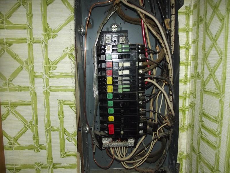

Yes, double-pole 90 amp w/stranded AL conductors, serving a built-in electric oven and electric cooktop. Yes - I did say 90 amp. That was not a typo :smiley:
The panel you have pictured Charlie, is a Zinsco - just in case you were not aware.
Hope there were no yellow jackets in there Charley. :slight_smile:
Some how I knew that breaker was on a cook stove and yes I knew my panel was a zinsco that is why I posted it. In the years I have been doing inspections in this State that is the first zinsco that I have found. House was built in 1952 and the panel was original
Mostly FP, Sq D, and CH used here

I don’t dispute what you say we as inspectors or thermographers don’t do load calculations not our job but it is our job to throw a red flag if we even think or supect there is a load problem and I do measure amps on the panel as my starting point to decide if I recommend a electrician or not.
Doing a test where everything is turned on at the same time and checking the ampacity is no more valid than adding up all the breaker ratings to say the service is undersized. Both are artificially biased tests and the results mean nothing.

I also like the thermo pictures of multiwire circuits such as dryers and ranges as once again it keeps the cash flowing when I once again do the calculation and shut down the picture.
