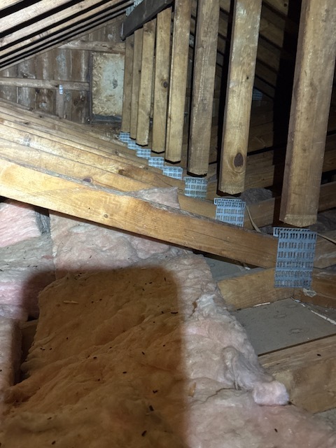

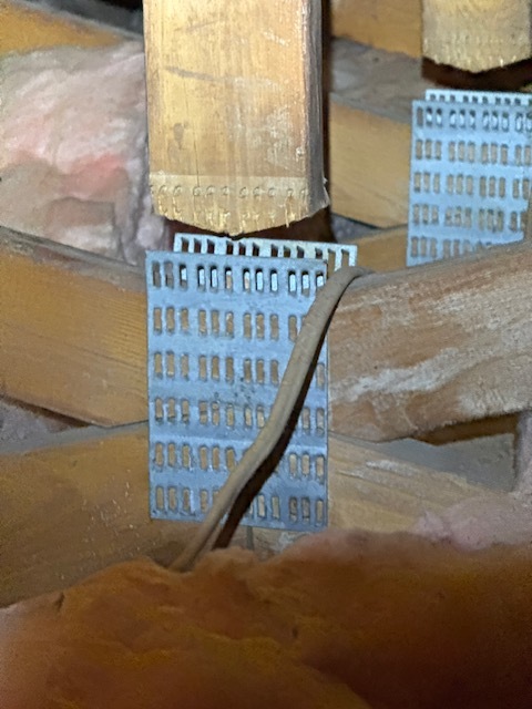

So I understand this is a defect and I understand I only need to report it, recommend further evaluation by a licensed structural engineer, and move on, but I’m trying for my own benefit to understand the reason behind this. I just left an attic where several of the (nearly all) of the vertical supports in a truss system where not meeting the gusset plate on the lower chord of the trusses. From indentations seen on the lower chord, it appears as though they were at some point connected, but what caused them to disconnect? They dont even appear long enough to reach the lower chord, as if the ends of the trusses where compressed pulling them upward?

The only thing I could imagine would be some kind of wind uplift forces
It doesn’t look like the plate had much engagement with the vertical supports. Maybe one full row of teeth in the meat, and one useless partial row at the very end.
Not sure what event caused the separation, but more holding power would be nice. Are you in a high wind or hurricane area?

I’ve seen the king post pulled out of the gusset plates on the top due to people storing heavy items in the attic, but this is a strange one for sure and I have no idea what would cause that to happen on the bottom of the king post.
What was underneath this area?
I’ve also seen something similar in a garage where they were using the trusses to pull engines.

Gaps between the gusset and the web members as little as 1/32" reduce the holding capacity of the gusset plate(s). Gaps 3/32" or greater have 0% effectiveness.
That type of gap is bad as well of course. I was referring more to the fact only 1 full row of teethe were really in any of the meat of the wood.

The gusset should lap the web member a minimum of one inch.

This was over the living room, the only lofted ceiling in the house.

I agree. The king post is in tension (vs compression) therefore a faulty connection could easily separate. This looks like a manufacturer defect that failed.
