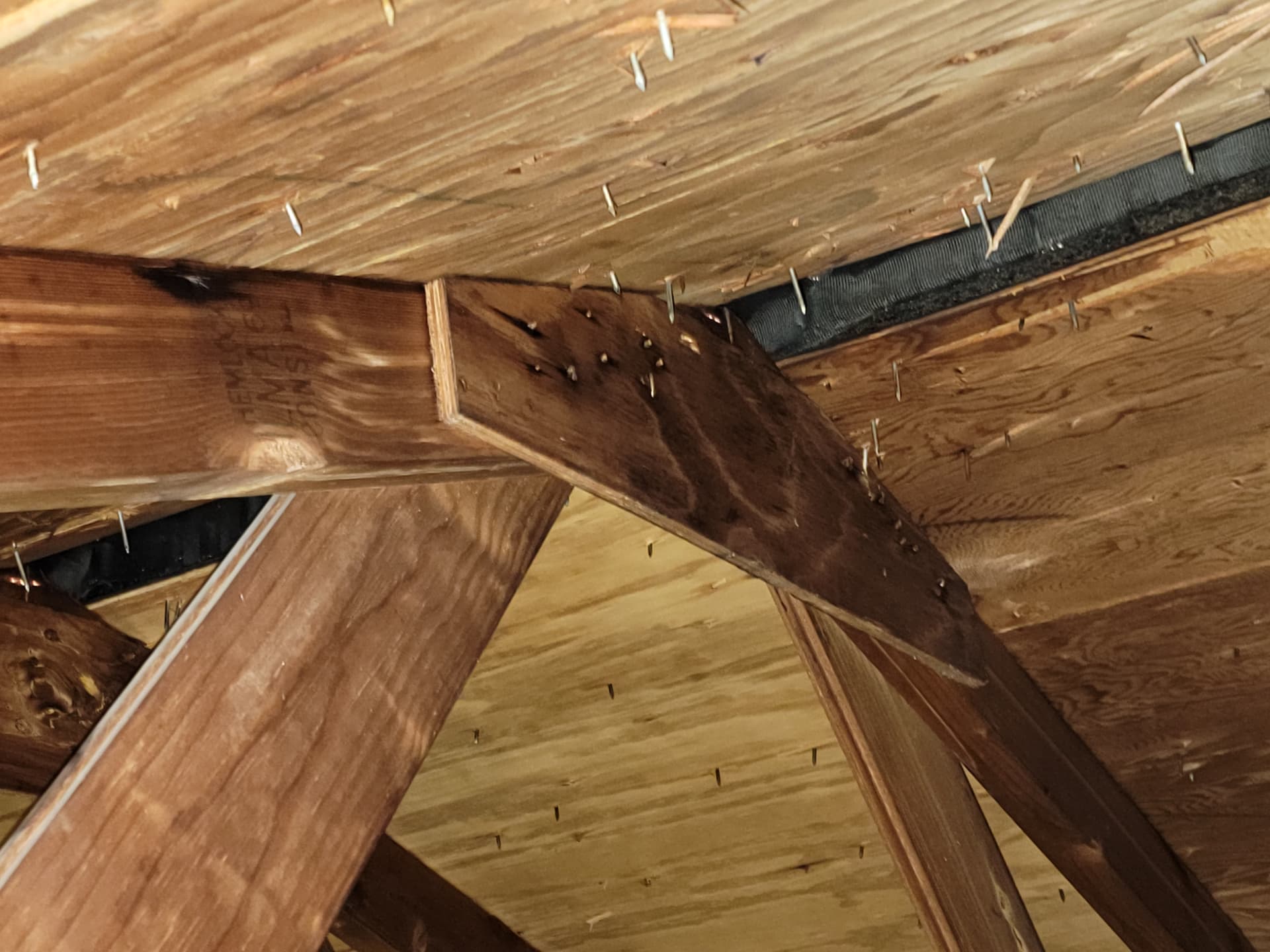

I wouldn’t. I’ve seen a couple through the years, as long as they’re performing with no visible issues, I’m wouldn’t be recommending further evaluation.
I saw these a while back, they look a lot like the ones in your pictures.
Thanks for responding Kevin. I deleted my post right after posting because I found some Nachi narrative information that mentioned similar to what Kenton stated, so I was going to go that route and refer to a SE. I appreciate your take as well because I feel the same as you on this one but I’m choosing the CMA route :smiling_face_with_sunglasses:
> Roof trusses appeared to have been built on-site instead of being assembled in a manufacturing facility. This indicates that trusses were not designed, inspected or approved by a structural engineer. Trusses that lack proper engineering may be structurally inadequate and have the potential for serious structural failure. The inspector recommends evaluation of the roof trusses by a structural engineer.
I wouldn’t either. I see these older systems in place often and if there is no issues I don’t recommending further evaluation.
I do not believe this is accurate. Are you saying engineered systems cannot be built or assembled onsite?
I didn’t write this narrative nor have one ready since this was the first time seeing site-built trusses in the wild. I spent a lot of time researching the archives and listening to the master inspectors to determine if I should write it up and come up with a narrative. I also searched Kenton Shepard’s library (I bought his template and found this one). I trusted his expertise as well as inspectors in other posts (as I mentioned in the prelude to this narrative in the above post) that almost always refer site-built trusses to a SE.
I trusted Kenton’s expertise so I used his narrative. I believe this narrative is applicable to a 1961 individual truss hand built on-site and may be appropriate for this era. I don’t know if I would have used this narrative for a 2025 build but I would have checked the archives :wink:
Here is just one of the posts I read from 20 years ago: Site-built trusses- always recommend a structural engineer? - #20 by mcyr
Maybe this explains what Kenton was referencing:
Why does everyone assume these were not designed by a competent architect or engineer? Did Kenton just operate off a sketch? What about the rest of the home?
I’m looking for the defect. Is there a commonly known high failure rate? What is the visible problem with these 60 year old systems?
