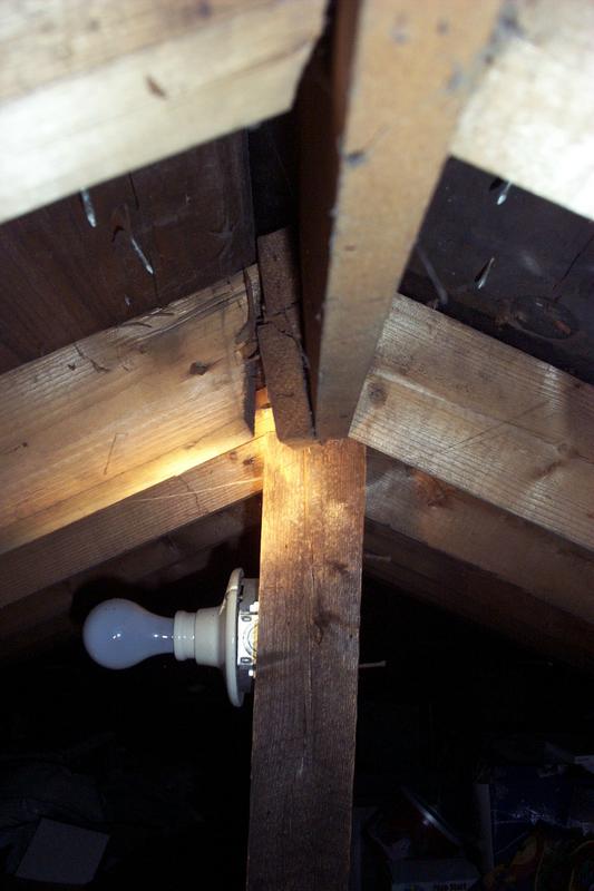

Ok, now you are ready for the underside. When I went into the attic, I looked up at the center ridge board and the defect was obvious…
As you can see, the center support post was placed right on the center of the ridge board (with no bracing on the two outer sides of the ridge board to hold the load bearing weight firmly in place). This improper support caused the ridge board to twist out of place.
The builder should have custom cut this support so that it could be placed firmly and directly under the roof rafter area. That would have prevented the twisting action of the ridge board.
Keep in mind, that every roof sag tends to have different issues. There are times where I find missing collar ties and the sag is simply settling from snow loads.

Great pictures David, thanx for sharing.
Thanks for sharing the pics David. Yeah, everything looked fine on the inside. With trusses, obviously there are no issues with collar ties or ridge boards, but I could see nothing to link back to the problem that was visible from outside. I’m curious about the pics though … if the support in your situation was placed in the centre, or thereabouts in the roof, would it still not be the high point, with the rest of the roof settling around it
A ridge board needs no center support! I’m sure that post was added after the fact by someone who didn’t know what he was doing. Ridge boards are not structural; they are only a nailer. They probably added that post after their ridge began to settle, and that would happen because the rafters were thrusting outward, possibly because of inadequate rafter ties, or undersized rafters. I’m sure they didn’t ask themselves what would hold up that useless post, either, because obviously, it didn’t solve their problem.
This particular ridge board obviously needed support, or it wouldn’t have twisted out of place like it did. The problem is, the homeowner or builder reinforced (sub-standard repair) this roof structure improperly.
The snow loads were probably putting stress on the roof field and causing the center of the field to sag. The installer of this post thought that this additional center support would assist in preventing this sag to worsen. But due to it’s improper placement and incorrectly diagnosing the sagging problem, the twisting occurred.
It depends on the bearing point of the post. In this particular situation, the post was placed on a portion of the attic floor that had no load bearing advantage whatsoever on the underside. It’s one of those (scratch your head-Harry the homeowner) installations.
If anything has to be supported in an attic, the brunt of the load must sit on top of load bearing wall studs.

One problem in the roof framing pictured by Mr. Valley is that the ridge was not continuous, and neither was it spliced properly. It appears that the framer simply lapped the two sections of ridge, instead of butting them and applying scabs to their sides. But I repeat, a ridge **never **needs a center support, beause it is not supporting anything itself. The rafter ends at the ridge pictured are pulling away from the ridge, exactly as shown in the web site for which the link was given. Thus, obviously, the rafters have spread, twisting the ridges as they did so, and that is the cause of the saddleback roof. Some pictures of the condition at the point where the rafters bear on the walls would be helpful, as well as photos of the presence or absence of collar ties. That stupid post does nothing…never did, never could.
