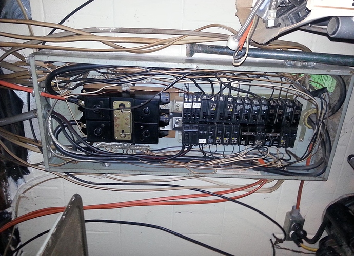

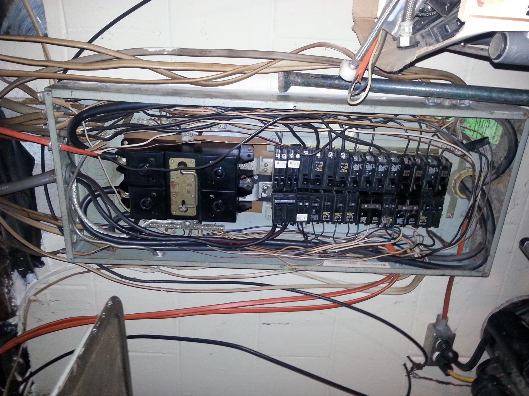

This is the electrical panel I inspected for this course. During the inspection I noticed that there has been a repair made on one of the bus bars. There is also a 100 amp breaker for the air handler which calls for a 60 amp breaker for over current protection. Also noted the cover was not installed when I arrived. This is a potential shock hazard. Several wires are capped off inside the box. There are also 4 different brands of breakers.

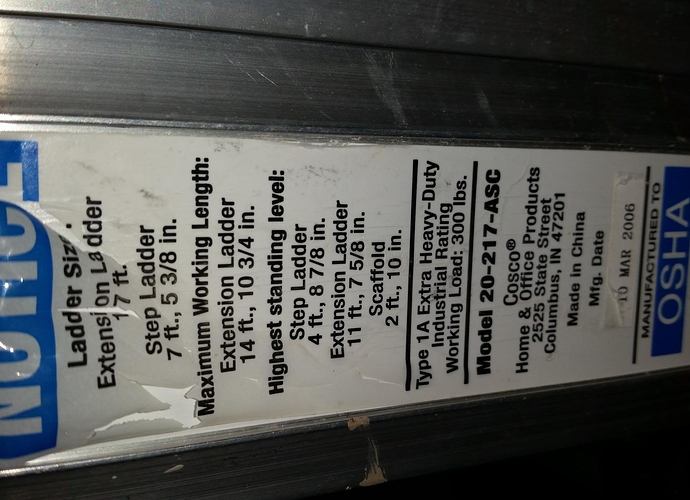

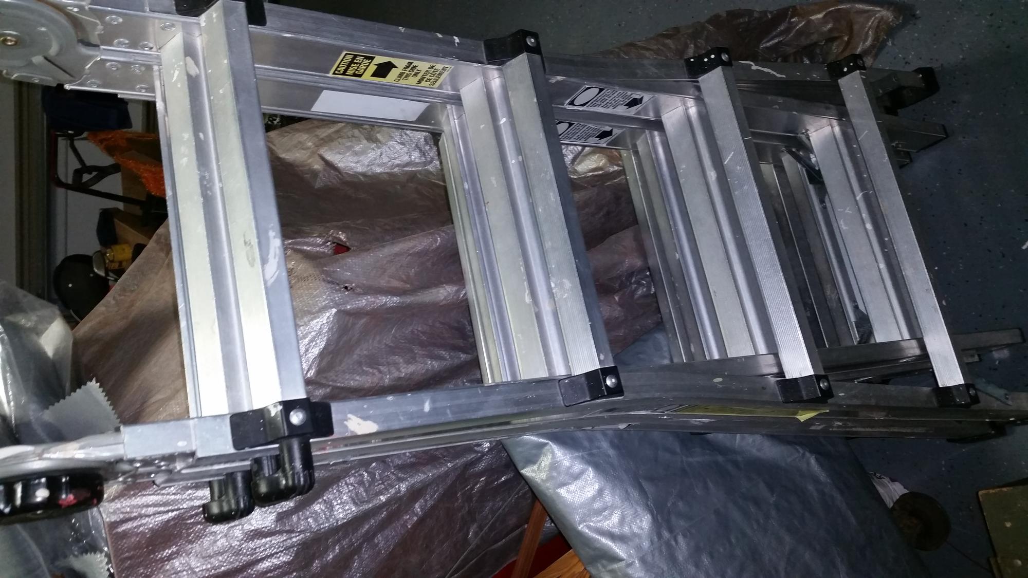

This is the ladder I like to use around the house. I bought it a few years back and it is still highly reliable today. It is an articulated ladder capable of extending out to a 17 foot extension ladder or can be used as a step ladder at about 7 and a half feet. The down side of this ladder is the fact that it is heavy, but it is rated IA which allows a 300 pound maximum work load that I find important because at 6’4" and 270 pounds, I am a larger guy.

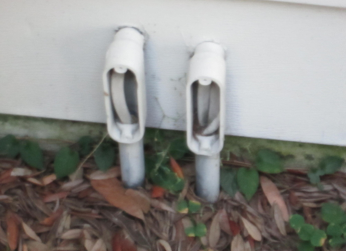

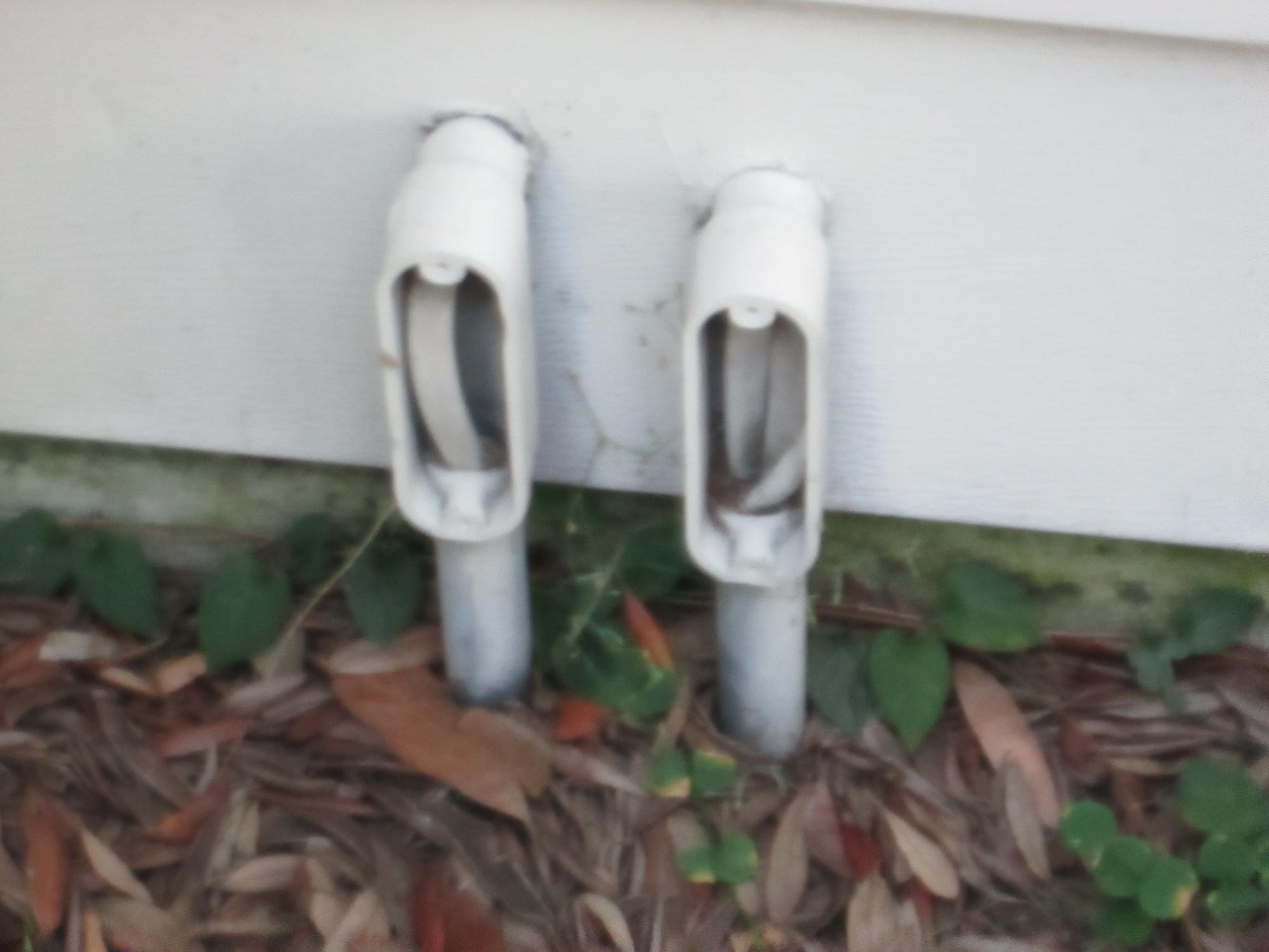

Here are 2 electrical boxes that is on the exterior of a home
exposed to the weather as of now wires look ok but they need
covers for protection.

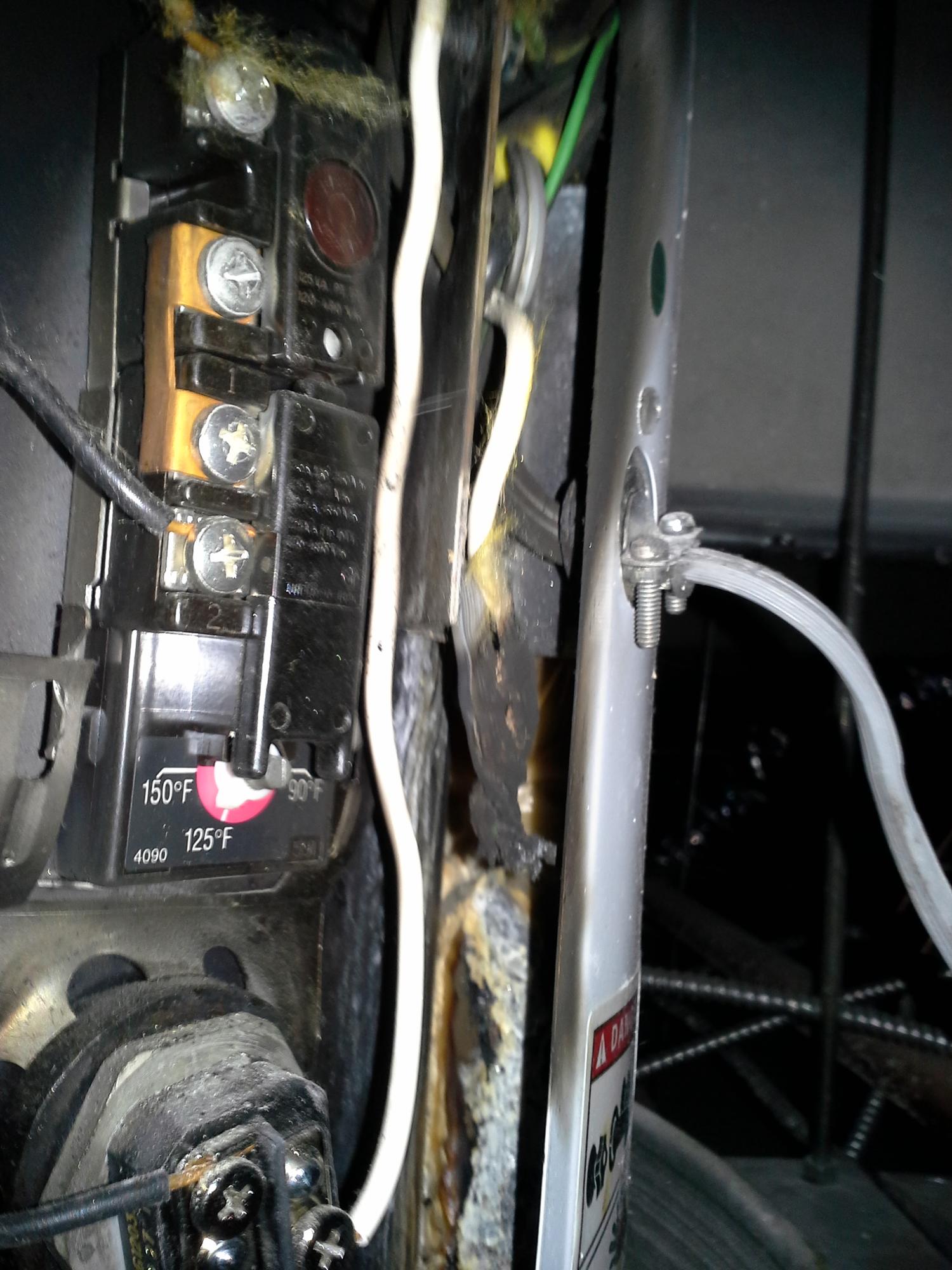

Visual inspection of accessible electric water heater in crawlspace reveals evidence of fire due to faulty wiring. No service disconnect present at unit location. Unit has been powered off at the circuit breaker panel. I have tagged unit and circuit breaker due to dangerous condition. Unit should not be used until serviced or replaced by licensed contractor. I have notified homeowner and agent of this deficiency and its hazardous condition.
I should note the contractors sticker should not necessarily reflect poorly on him or his business. The dangerous condition of this unit could have easily been, and likely was, due to a replacement thermostat control being installed by an unqualified person. Next time I upload an image I will edit out any contractor identifications.

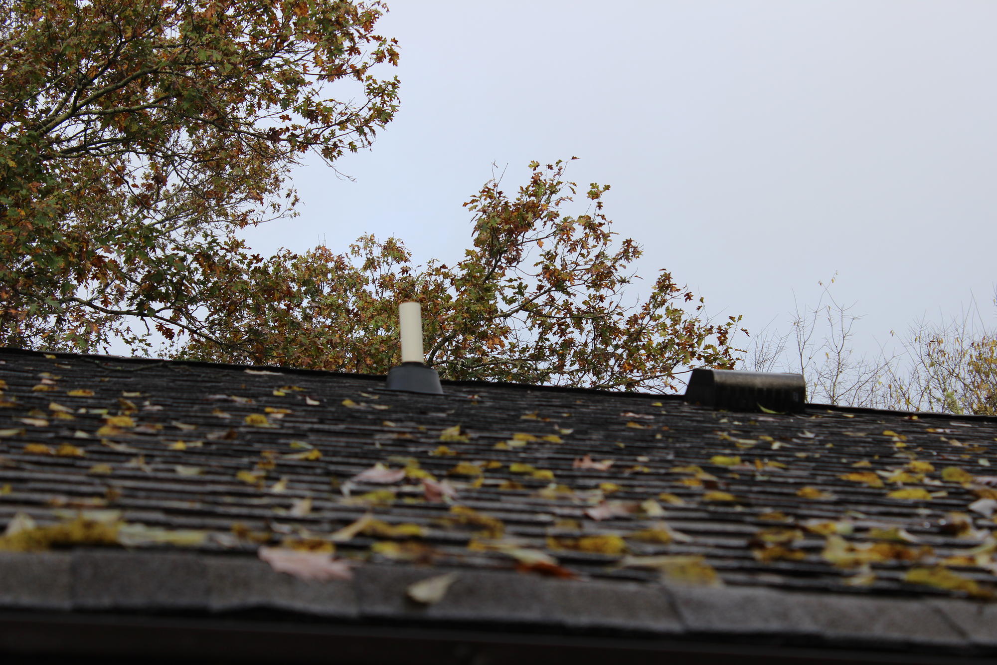

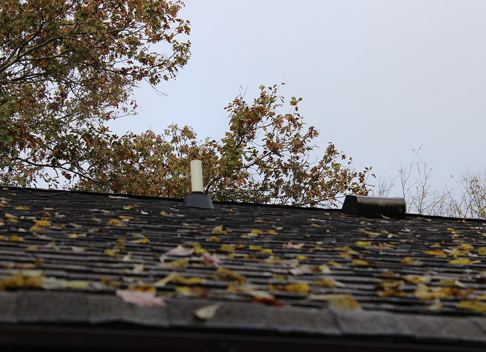

Visual inspection of roof from the ground level. The roof material was of asphalt shingles their was no indication of roof leaks. All vents on the roof seem to be undamaged and in working order. Gutters appear to be clean of debris the pitch of gutters where downhill towards downspout. Downspout appears to clean of debris also the ends of downspout are at a 45 degree pitch facing away of foundation. I think this was a perfect inspection sorry for not having any pictures I could not get them to upload.
