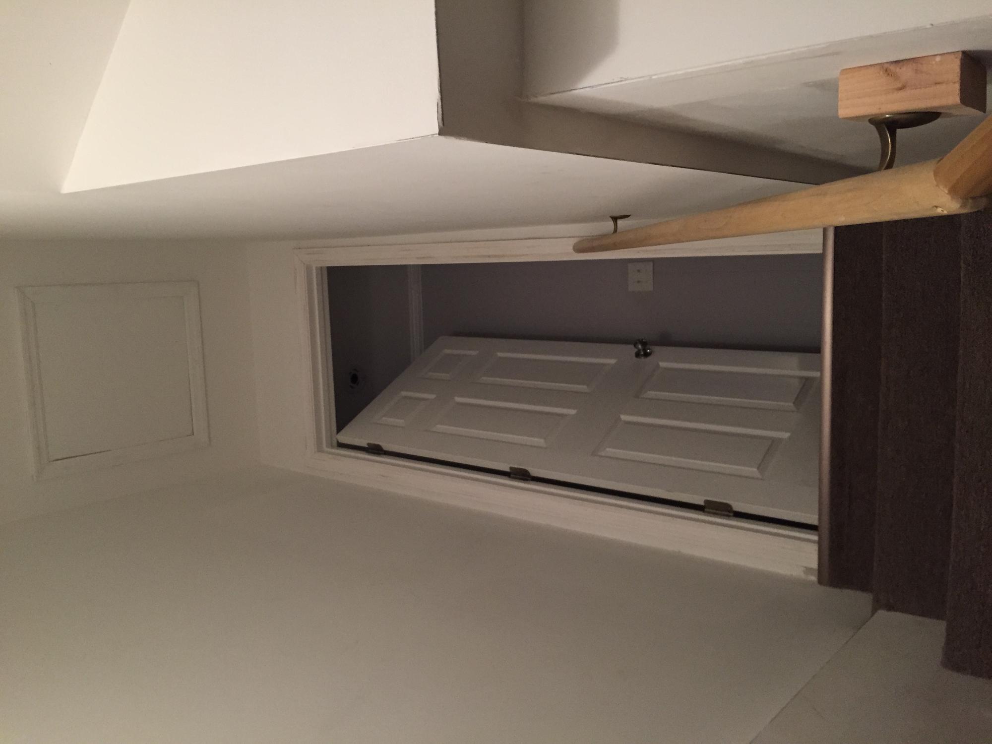

This is a situation I have in my own home. Thought this is good one to share since this course is about safety and hatch location was one of the subheadings under Attic Inspections. The attic hatch location is directly over the stairs. This poses a hazardous location due to the placement of your ladder would have to be on a stair tread. The safest way I think to handle this would be to have a second person with you to hold the ladder in place so it wouldn’t slide down the stairs causing the inspector to fall and possibly seriously injuring his/herself. Since an inspector would not know of this hazard prior to the inspection, having a second person is probably not going to be the answer. So I would think he/she would have to reschedule the attic inspection, but would go ahead and inspect the rest of the house. Any feedback would be greatly appreciated.

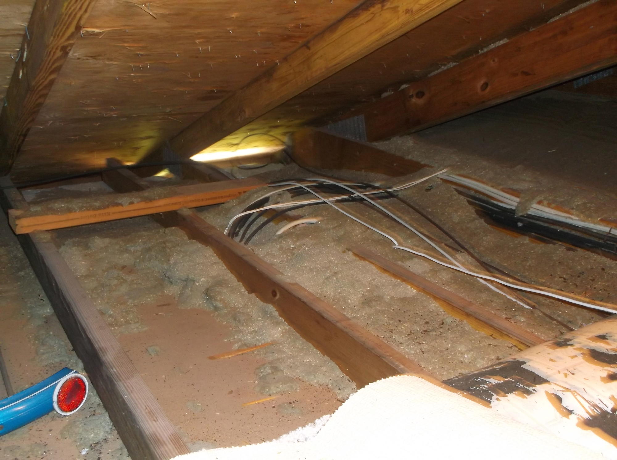

In the attached photo, the attic space was definitely “confined”. There was lighting present, but was inadequate to illuminate the entire space. Additionally, there was no sort of walkway to be able to reach other areas of the attic. The presence of protruding nails would have made it dangerous to try to crouch and step on the rafters to explore other areas of the attic.

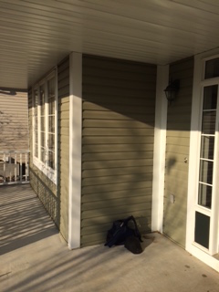

For this component of the course I have inspected the exterior of a two storey home.
Initial visual inspection reveals that the siding material is vinyl with aluminum trim and corners. Flashing around doors and windows is present and functional. No indication of any moisture penetration through the exterior is present.

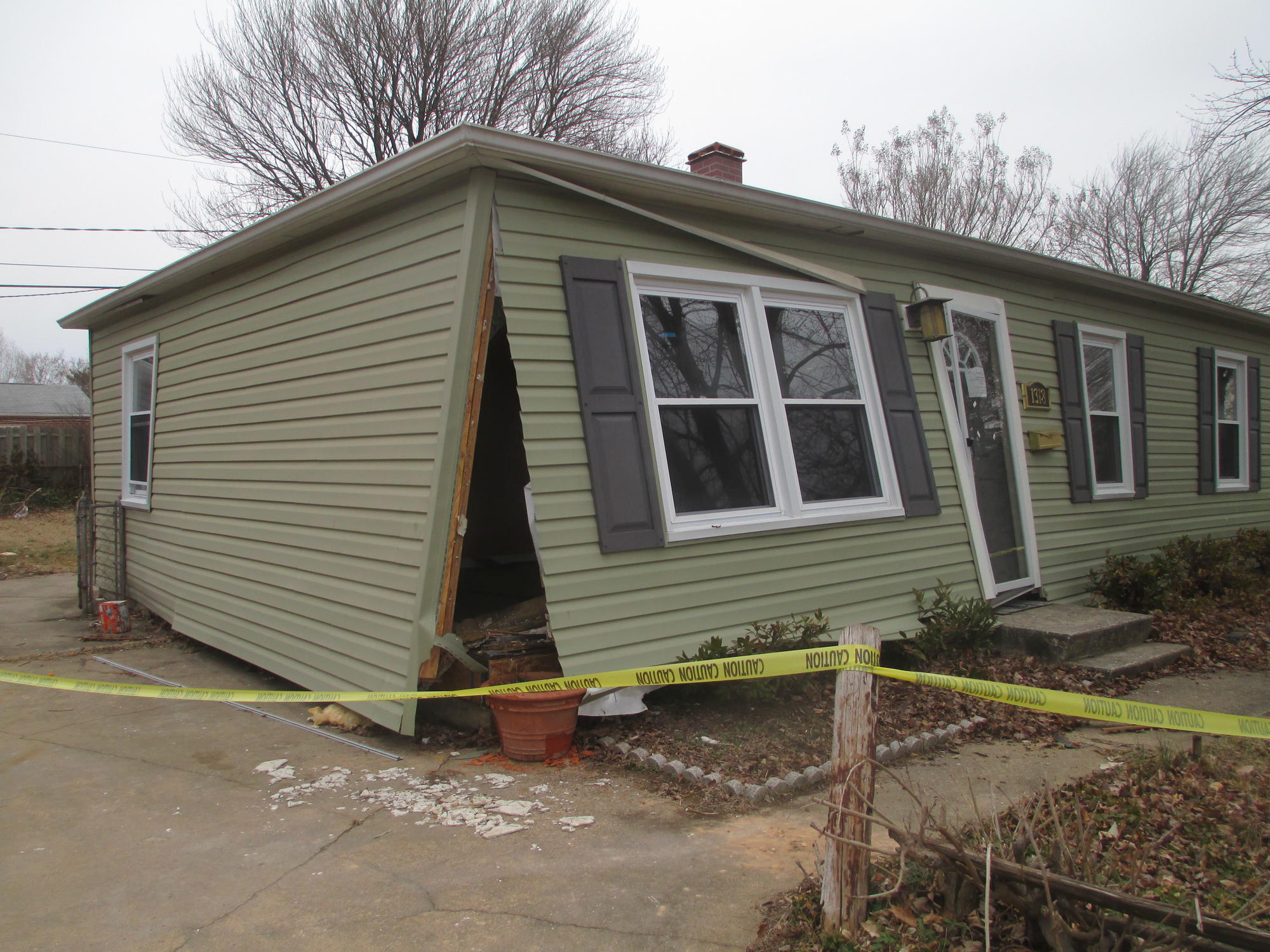

The second picture is of a house that had a gas explosion, knocking the house off the foundation. There were signs that read “enter at your own risk”. I did not enter, but peered through the rear door. You could hear the house creaking with movement. Did not enter house. Not safe.

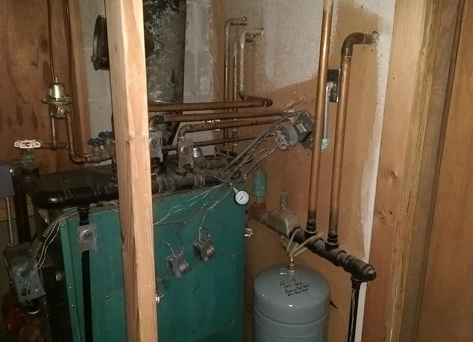

This home is heated by hot water radiant baseboard heaters, which are divided into 5 different zones throughout the home. The oil fired boiler heats the water and a circulation pump disperses the heated water to the appropriate zone after a call for heat from the zone thermostat. The boiler should be inspected and serviced by a qualified technician. Water leaks on top of the boiler were noted, and the zone control actuators are currently not fastened to the valves.
