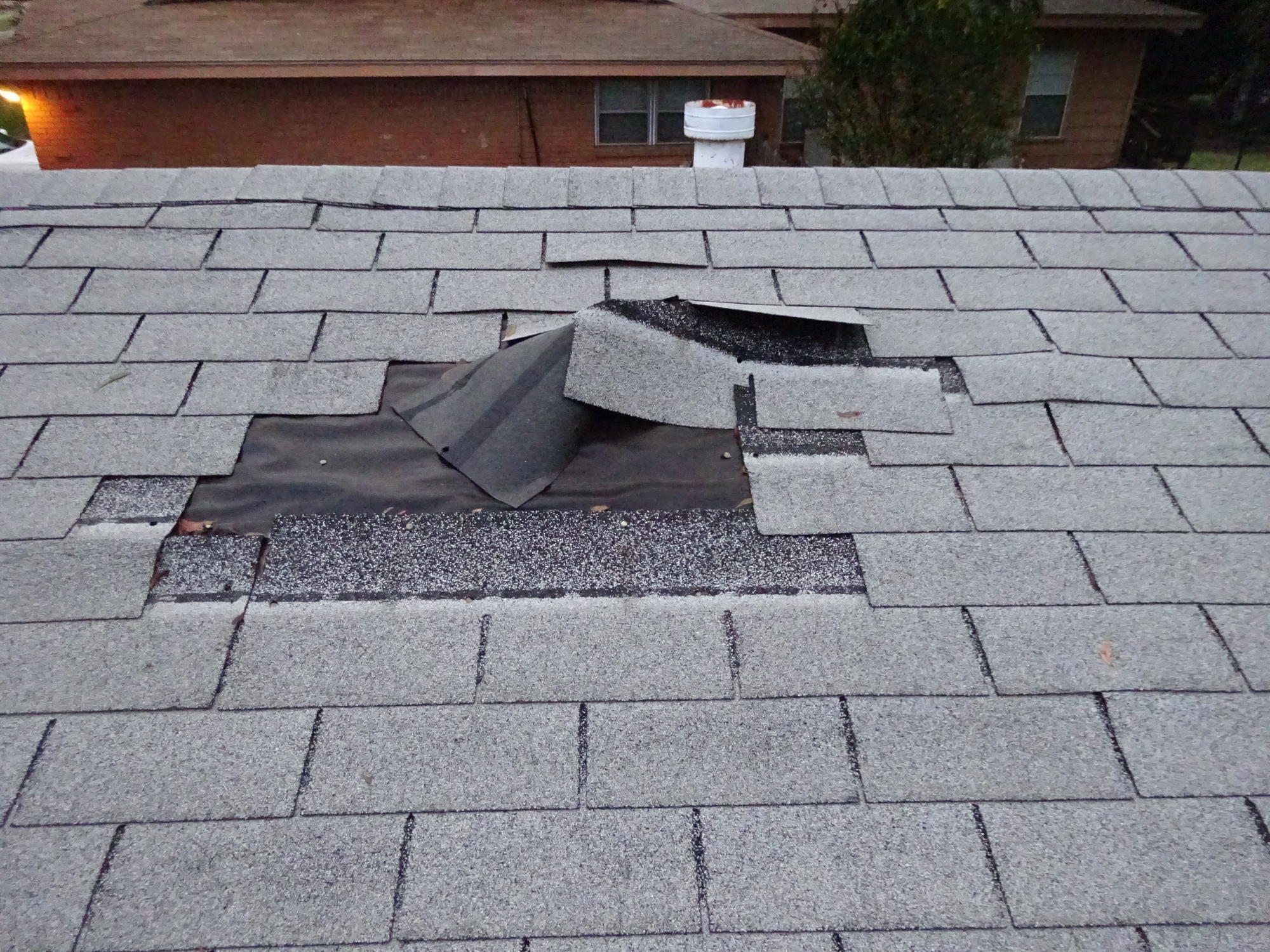

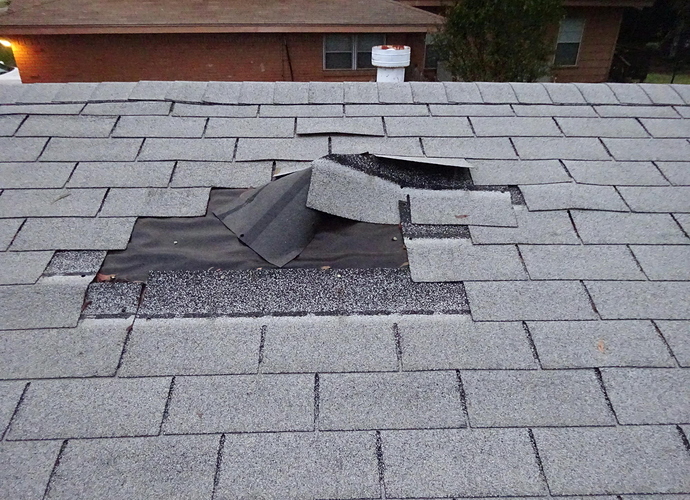

I inspected a home a few weeks back here in the Fort Worth area. We were having round of heavy rain fall. It was between these rounds of rain I was able to get up on the roof & found the shingle damage as shown in the video.
The roof while still damp & the wind strong I was taking some risk that I was barely comfortable with. I’ll be more cautious the next damp roof I step on. I would not have seen the extent of the damage with out getting on the roof. We later discovered as it began to rain a large leak caused by this roofing issue.

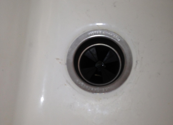

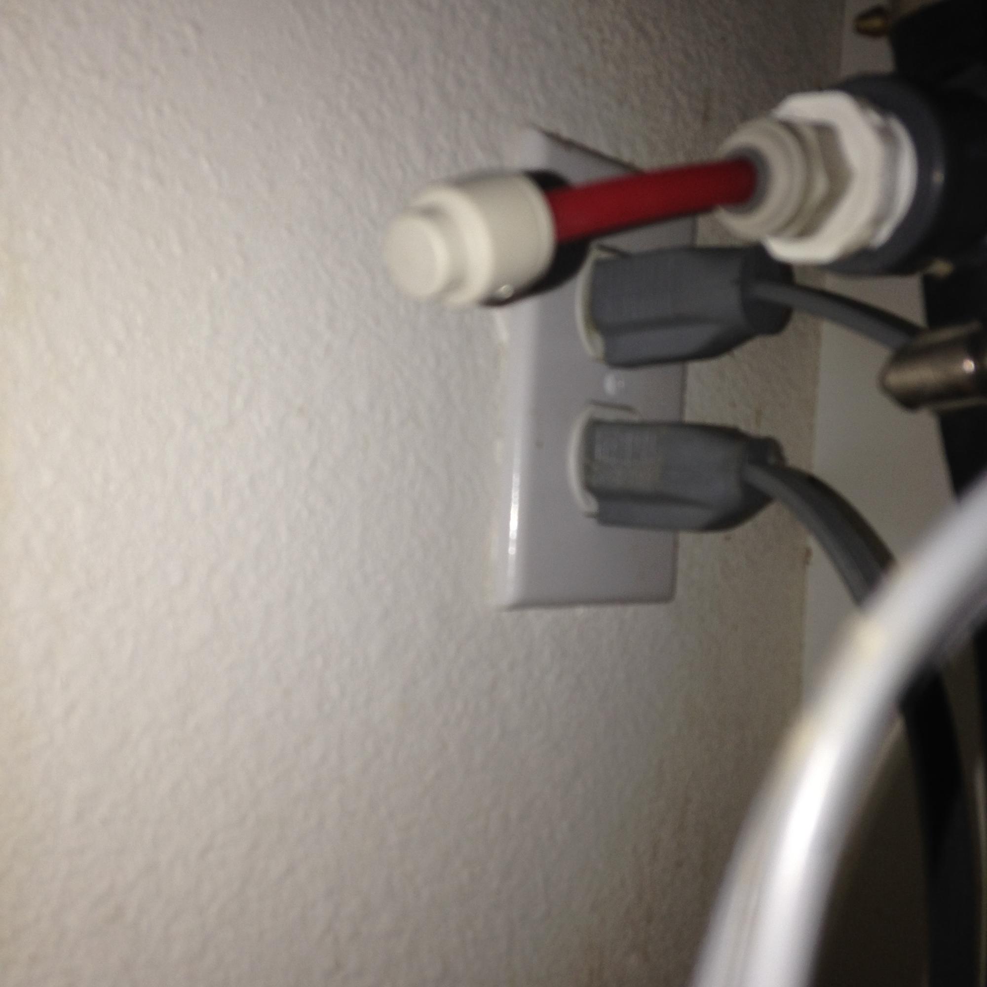

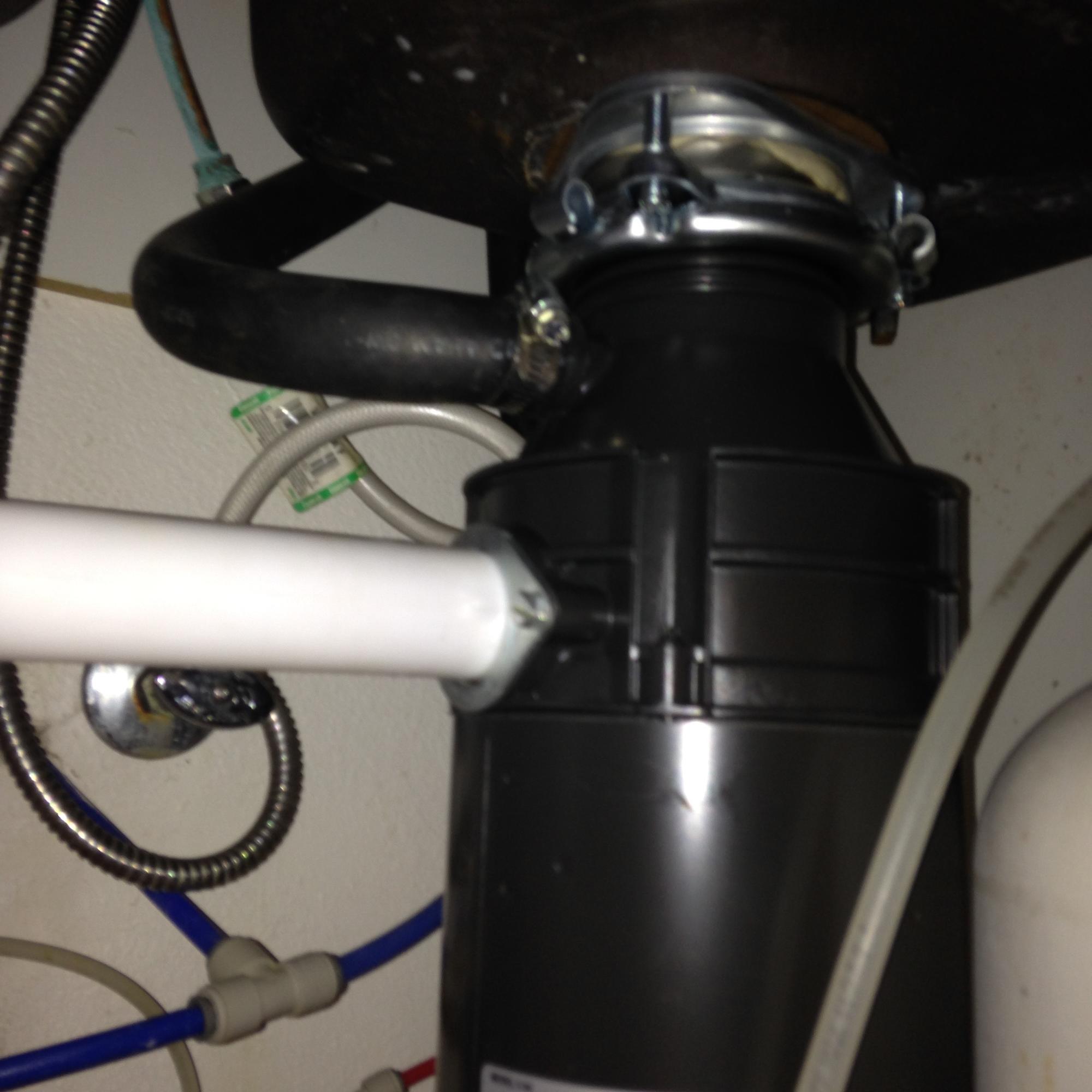

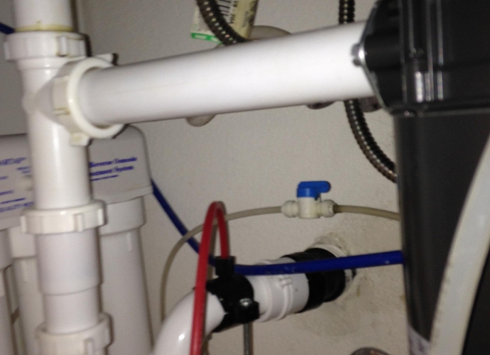

Disposal Inspection,
The disposal in this home is installed properly and up to all modern codes. It is dedicated on a 20 amp breaker. it is switched within reach of the sink. and while running water through it and using it to grind up solids it drains properly without leaking.

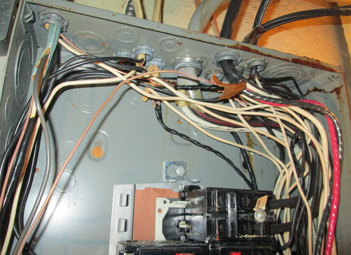

This is a great article that identifies several safety issues in an electrical service panel in a fun, clean, and safe way. The pictures below are from actual inspections, and with the benefit of hindsight the electrical panel probably should not have been opened from a safety standpoint. We do our best to keep everyone safe, and sometimes safety issues aren’t identifiable before opening the panel. Other times the safety threat is more obvious. Other times a threat may seem to exist but upon further investigation it turns out to be a minor annoyance.
I didn’t realize the panel was dripping with water until I opened it up. I’m just glad no one was hurt, we let everyone know right away.

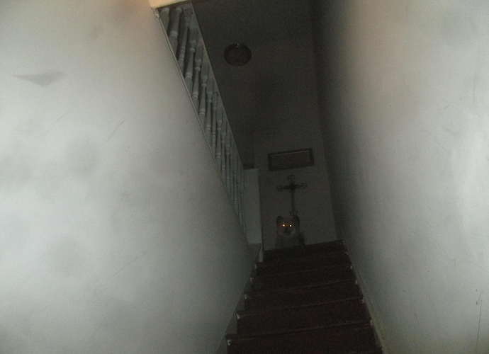

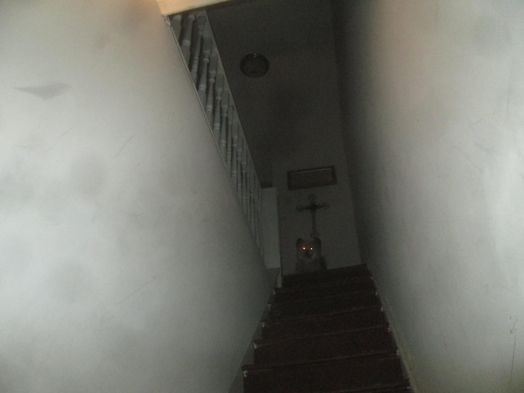

Inoperative lighting fixtures at the stairway to the 3rd Floor unit, notice the glowing eyes at the top of the stairs. To my relief “Cujo” turned out to be about 10 inches tall and less than 20 pounds.

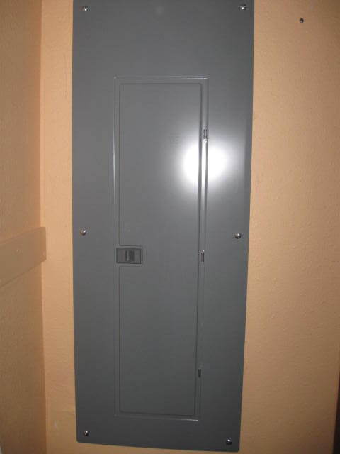

Inspecting the home electrical panelboard poses serious risk of injury if not address properly. It is essential inspectors wear the right PPE for the task. Eye protection, boots, gloves, and test equipment must be used to reduce potential injury to the home inspector. Utilizing the right PPE, the home inspector should first determine if the panel is energized. An energized panel can occur for several reasons, either which could cause personal injury. If determined to be energized, abandon attempts to inspect the panelboard further. The inspector then must clearly post a warning tag to alert others to the potential danger, then provided verbal notice of the hazard to the owners and potential buyers ago with annotation of the issue in the home inspection report.

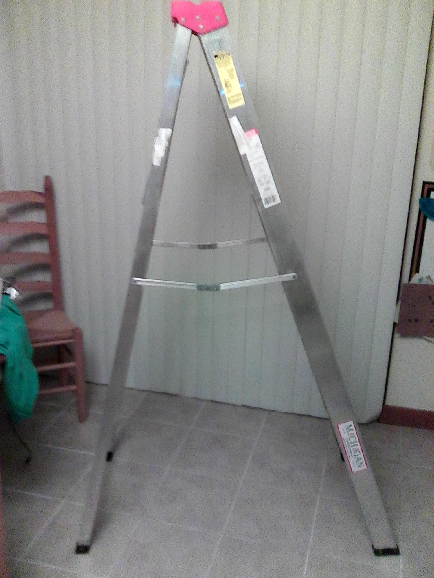

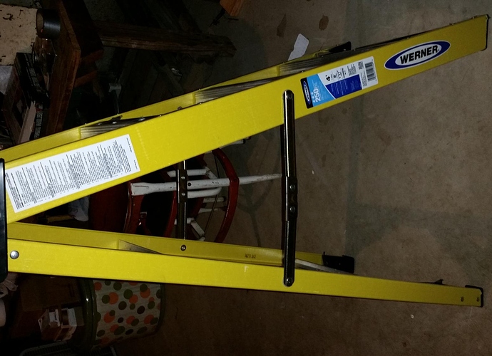

I chose to inspect my 4 foot step ladder. The ladder is in excellent condition. There are no cracks or breaks in the fiberglass side-rails or metal steps. All fasteners are tight and secure. The spreaders are smooth tight and not damaged in any way. There are no rungs missing, safety feet are sound and unbroken, and all moveable parts operate freely.

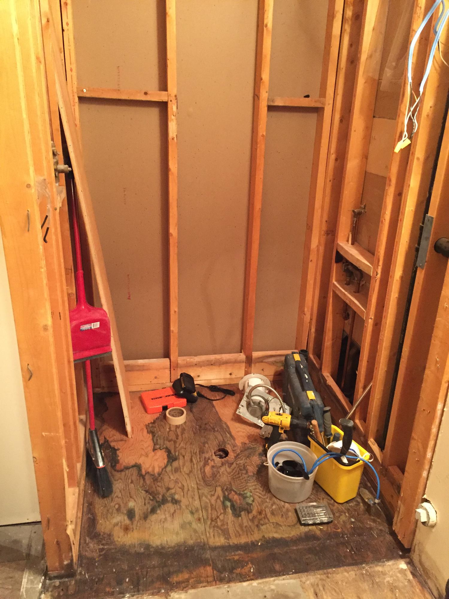

After careful inspection of this gutted walk-in shower, mold was found on and under the plywood flooring. The flooring is to be removed, making sure to use the proper PPE, and a new floor installed. A thorough cleaning to ensure no mold sproes have around is also needed. Also, need to get the hanging live wires tucked away and capped properly.
