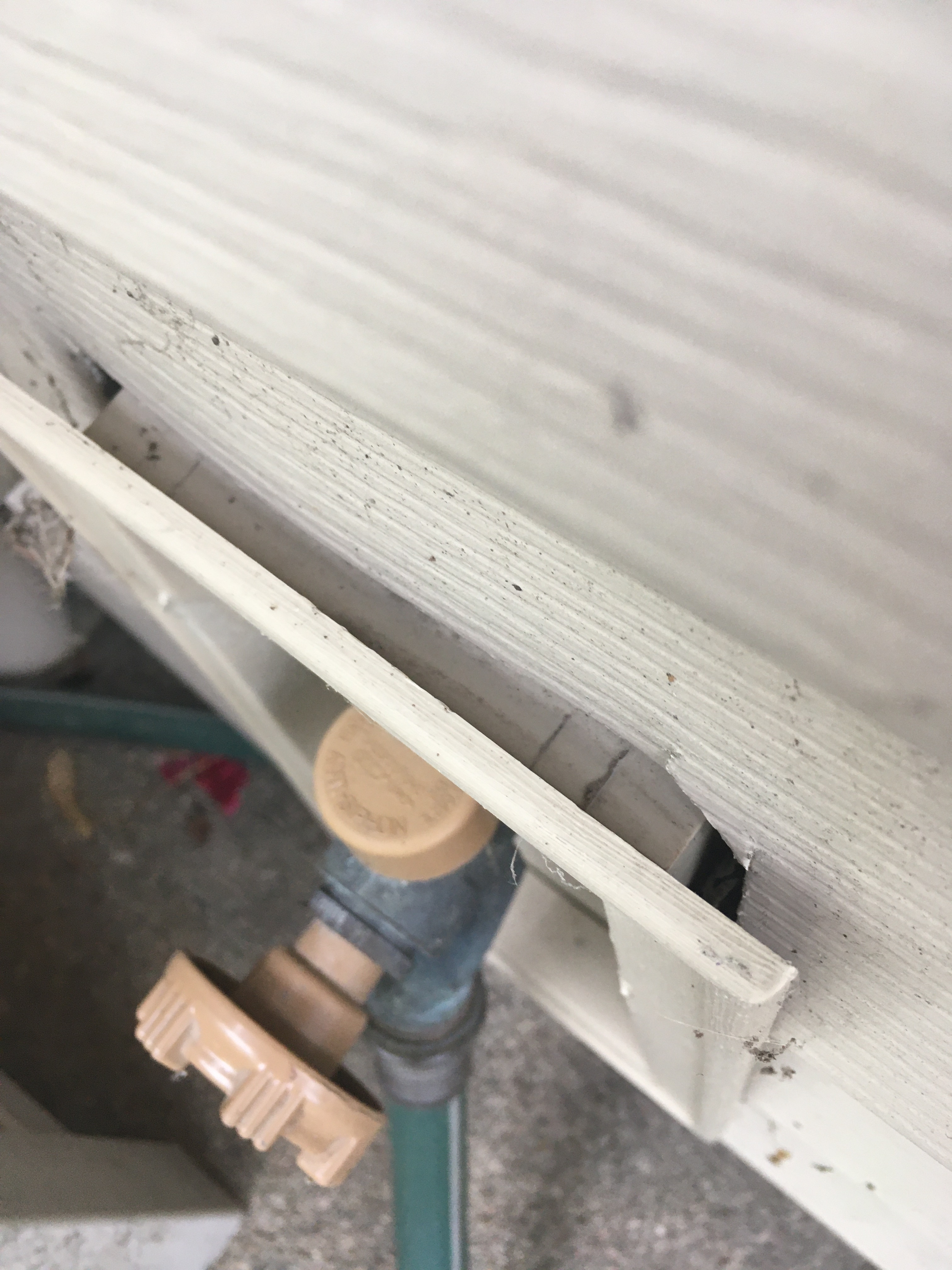

Hey everyone, just a quick question on if there are any situations where vinyl siding should be sealed. I know that the seams and J-channels should not of course, to allow movement. I believe the gap between the siding and brick veneer in the photo should. My question is about the gaps around penetrations such as the outlet housing and hose bib? It seems like these would be easy places for moisture intrusion but then of course there’s the concern about allowing movement. Call this out or no?
Thanks, Ed

Even if installed correctly, vinyl siding is not waterproof.
As Larry said, Vinyl siding is not weatherproof, and thus the importance of the Weather barrier under the siding. If the WRB was not installed properly, you will get leakage.
“Vinyl siding has always been designed as an exterior cladding, not a weather resistant barrier. Vinyl siding is designed to allow the material underneath it to breathe; therefore, it is not a weather tight covering…. To achieve designed performance, vinyl siding must be installed over a weather-resistant barrier system that includes 1) a continuous weather resistant material and 2) properly integrated flashing around all penetrations and where vinyl siding interfaces other building products such as brick, stone, or stucco” [3] (emphasis added).

Since IRC 2006 weather resistant barrier has been required under vinyl siding.

I used to install a section of flashing that came out onto the brick with about 1/2" profile so that it could be caulked to the brick and to the jchan. Water running downward has an opportunity, thanks to cohesion, to wick up behind the jchan. While there should be a weather resistant wrap, it can still cause issues over time. Loosening, rusty nails, little rot spots, etc…
I write it up as missing flashing/caulking. If nothing else is prev. main. and helpful.
