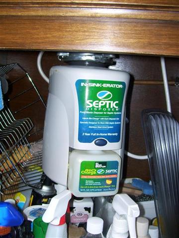

Yesterday’s home had the Insink-Erator device which the AHJ failed. The septic tank leach failed too.

Did he say why he failed it?
In-Sink-Erator makes disposers specifically for homes with septic systems, which that one seems to be. They work quite well.
Of course, I can’t tell from the picture whether or not it is installed properly.
