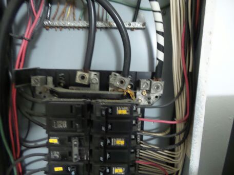

Mismatched breakers noted , breakers were Challenger and electrical panel General Electric.
Some screws were missing in panel therefore panel were not tight and secured enough ,presenting openings in which animals,dust and moisture intrusion can occur Licensed Electrician is recommended to repair issues.
No GFCI or AFCI breakers noted at time of inspection , installation recommended by a Licensed Electrician .
