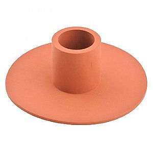

Buy or make a shower pan test plug to put enough water in the shower pan to load it. leave it that way during the inspection and inspect the outside after a suitable time lapse. Don’t expect accurate moisture meter readings on ceramic tiles, always compare to a known dry spot.SPTS_Shower_Pan_Test

Too many inspectors have found their way into court when using this devise, and forgetting about it while the shower was running. I would NEVER use this thing……. bad idea!

Well, if your going to leave the water on you certainly don’t need the drain tester! I wonder if they’re the ones who leave the lights on and the doors unlocked?
