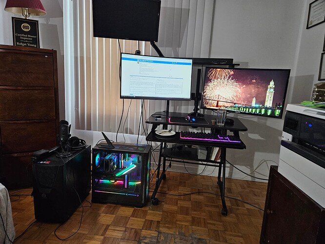

I built a powerful computer for that very reason.

Here’s my PC and office. I built the 2 PC’s n the image.
