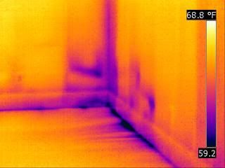

Dryer or exhaust fan not cut through the siding.
A thermometer would have given similar results…![]()
And if one wants to get fancy than an IR Thermometer would have negated the use of a Ladder… ![]()
Well very true Mr Kelly if you could figure out where it was coming through ( which way it ran) The small bulge did give some indication on this one but on the home next door it did not. No Bulge on that one. I do not make it practice to run a thermometer around each piece of siding. At first we where thinking it dumped in the porch area. It took seconds to find with the thermal , Now the old way probably 30 to 40 minutes. I was only showing what the camera can find . Simple straight forward. It’s has more to offer than not. I use mine every day , included in all inspections ( this is for me).mostly. If inspectors do not want to use one thats up to them.

Thermometer may have missed it 16 up 8 feet away Spot beam 3 to 4 inches . at best
i had the dryer turned on less than 3 minutes . found it as soon as walked around the home. I was thinking ( in firefighter Mode now) what if i had to run it longer Perhaps a fire?
