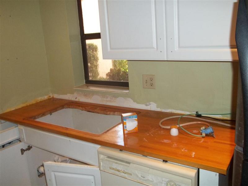

I was going to do an inspection last week on a condo and I asked the Realtor if the water was on. she went to the property and said no. She then turned the water on. Guess what happens next? One of the valves under the non-existent sink in the kitchen was open and when she tried to shut the main back off, it broke!
