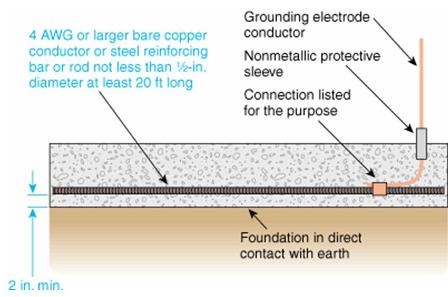

The rebar is required to be at least 1/2 inch in diameter and in “one or more lengths” totaling 20 feet in contact with the footing, or an unbroken 4 AWG can be used.
Originally Posted By: jtedesco This post was automatically imported from our archived forum.
Quote:
Concrete-Encased Electrode. An electrode encased by at least 50 mm (2 in.) of concrete, located within and near the bottom of a concrete foundation or footing that is in direct contact with the earth, .....
I will ask for some help from someone here who can tell us the required depth of a concrete foundation or footing.

If you go where it never gets below 0c the footer can be 8" deep, 12" wide (“bell footer” on a slab house). They put the plastic under the 4" deep slab but not the outer 8" rim of the “bell” where the footer is. You get 2 #5 rebar 2" to 4" up from the bottom. The current argument here is whether it is OK to simply turn up a piece of rebar for the EGC to connect to or whether you need a <typical> #4 copper with an acorn on it in the slab and stubbed up to the panel. The problem with that is they end up breaking it a lot, then you have nothing.
The argument is the turned up rebar, if it is exp[osed, will end up rusting off at the point where it exits the concrete.
What my wife’s company is doing is to bring up the stub into a core of a block that they knock a hole in. (paint the block green so it doesn’t get poured solid with the dowels!)
The sparky makes his connection after the block is done (that was when the damage happened) and then they seal up the block to prevent corrosion.

It is sealed after the electric rough, the stucco guy does it, they pack the hole with type S. They use an acorn clamp that is listed for encasement in concrete. The alternative is to put a mud ring in the wall and a blank cover but you still have the corrosion issue. If water collects behind the cover it can rust the rebar off.

I might be wrong here but when placing a ground into concrete, would it not be required for that connection to be cad welded? Art 250 is always bonkers to me

250.68 Grounding Electrode Conductor and Bonding Jumper Connection to Grounding Electrodes.
(A) Accessibility. The connection of a grounding electrode conductor or bonding jumper to a grounding electrode shall be accessible.
Exception: An encased or buried connection to a concrete-encased, driven, or buried grounding electrode shall not be required to be accessible.
*** You can bury the connection in a concrete encased electrode
250.70 Methods of Grounding and Bonding Conductor Connection to Electrodes.
The grounding or bonding conductor shall be connected to the grounding electrode by exothermic welding, listed lugs, listed pressure connectors, listed clamps, or other listed means. Connections depending on solder shall not be used. Ground clamps shall be listed for the materials of the grounding electrode and the grounding electrode conductor and, where used on pipe, rod, or other buried electrodes, shall also be listed for direct soil burial or concrete encasement. Not more than one conductor shall be connected to the grounding electrode by a single clamp or fitting unless the clamp or fitting is listed for multiple conductors. One of the following methods shall be used:
(1) A pipe fitting, pipe plug, or other approved device screwed into a pipe or pipe fitting
(2) A listed bolted clamp of cast bronze or brass, or plain or malleable iron
*** You can use a clamp if it is listed for concrete encasement
At least that is the way the AHJs read it here. YMMV if your AHJ's brother in law sells CadWeld kits
