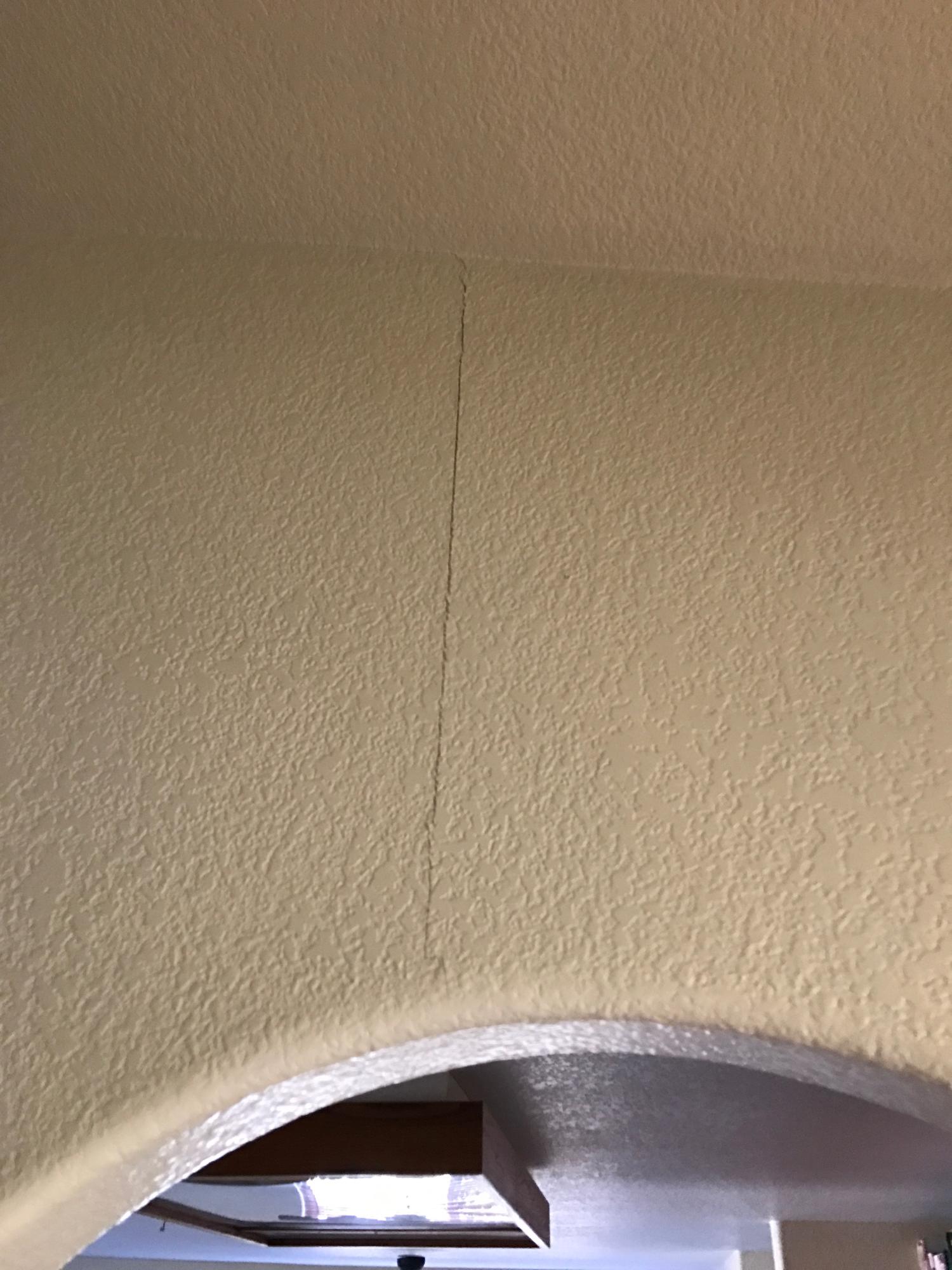

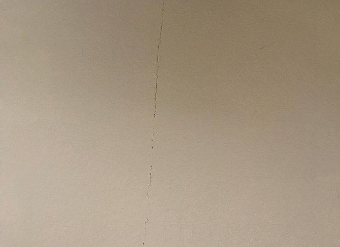

The living room is showing some cracking in the drywall. Investigating further it is noticed that the crack is in a similar location on opposite walls. Going into another room looking at the wall for the same problem, no issue is found. It can be said that some settling in the home has occurred. Looking into the foundation, no issues were found in the unfinished basement. The home is 19 years old and is a ranch styled house. Recommend to monitor the cracks for further evaluation. If the cracks become larger or change contact a structural engineer to address the issue.

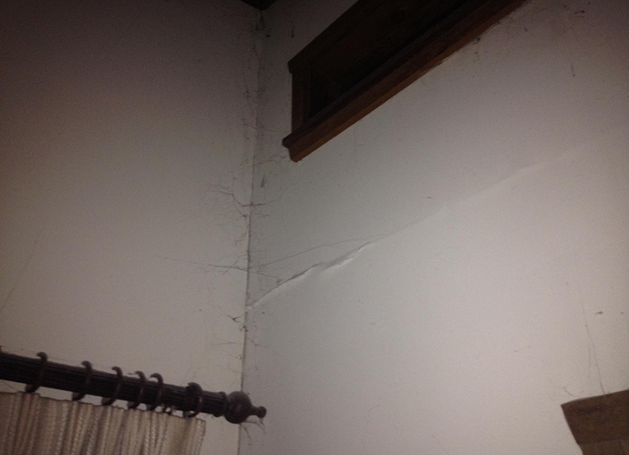

The attached picture is showing separation of the sheetrock in the corner and also stress cracking above the window. This portion of the house was added 20 years after the initial home construction and is showing settlement of the newer addition where it is tied into previous construction. This would be noted in the report.

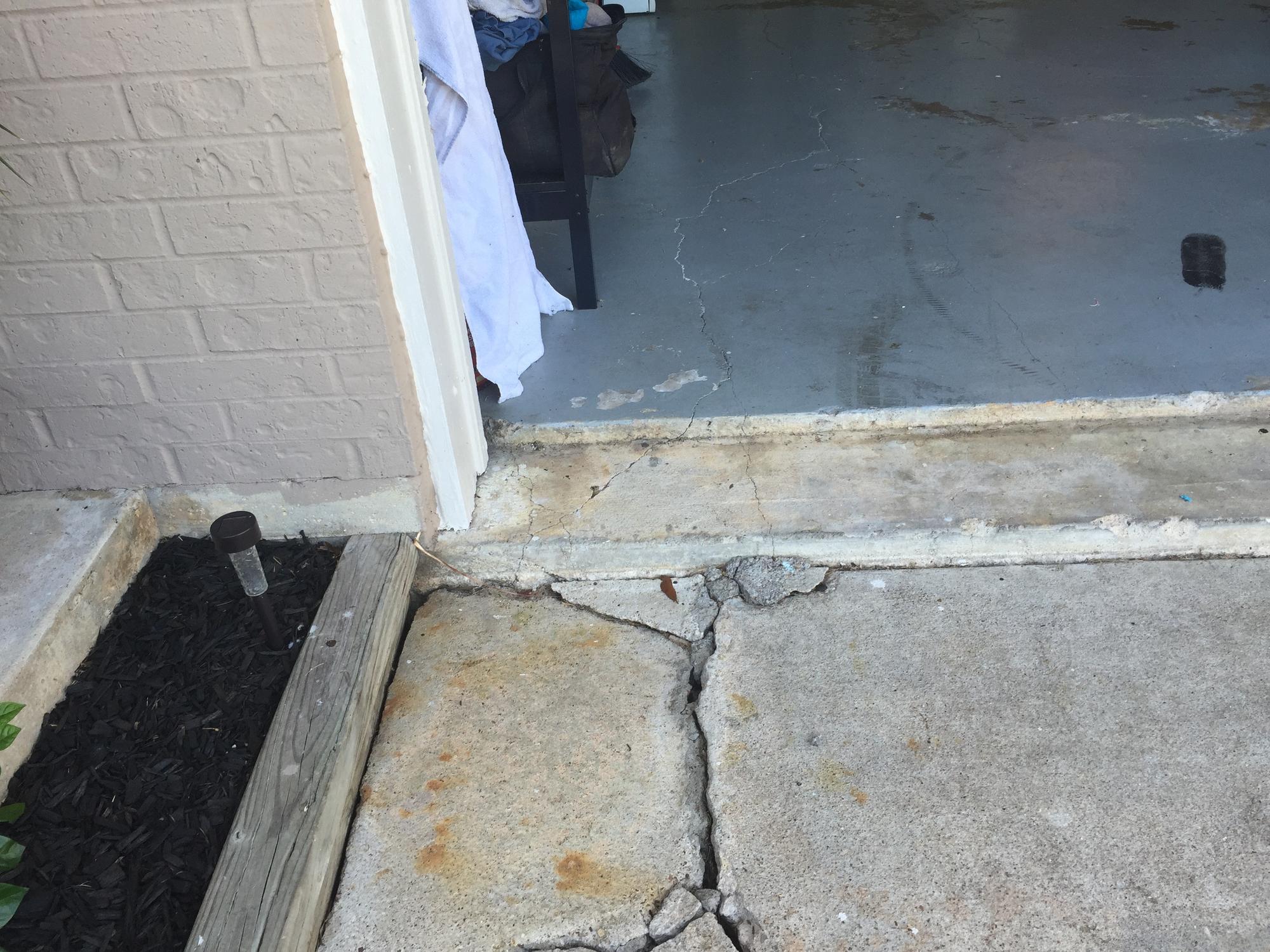

During this inspection of a home had with slab on grade foundation with signs of cracking. Differential settlement was noticed throughout the driveway and the cracking had followed through to the slab supporting the home and had shown up with stair-step cracking of the masonry exterior wall along the garage end wall. Additionally, the inspector utilized an altimeter and determined the front corner of the slab foundation had settled 2.4” below the grade of the home. The inspector recommended that a structural engineer should evaluate the foundation to determine what steps should be taken to stabilize the slab on grade foundation.

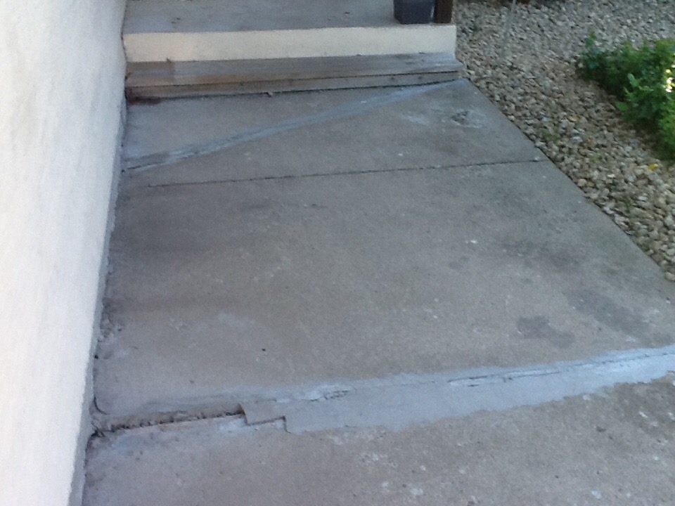

At this inspection I found the front walk way had sunk about 2 1\2 in toward the home. This caused rain to pool in this area and then drain to the basement. I advised my client to get assistance from a cement jacking company or have the walk replaced, draining away from the home.
