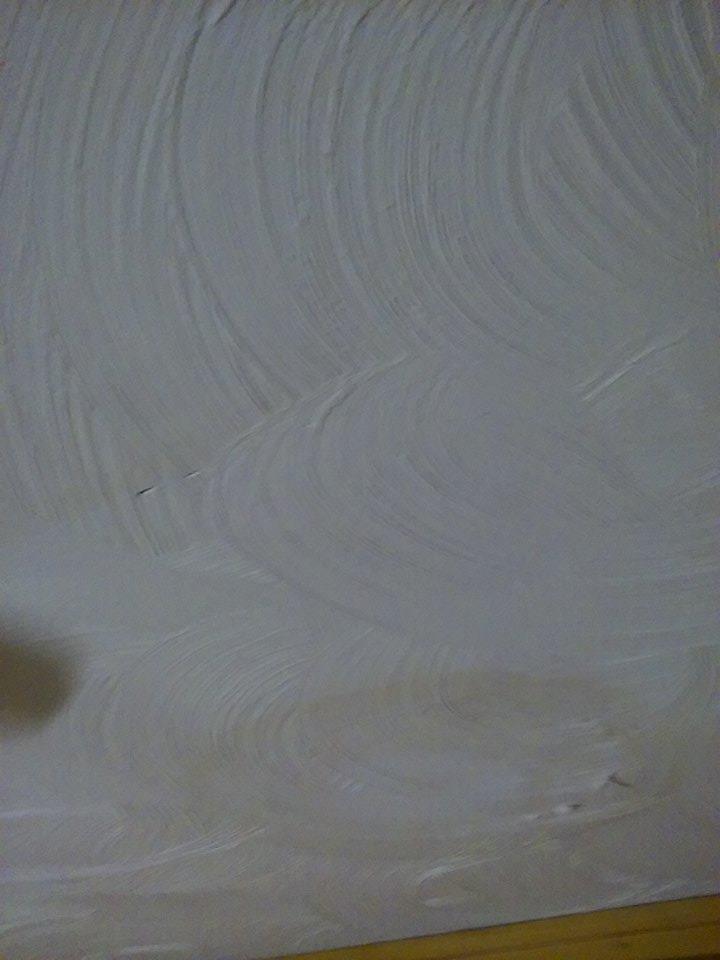

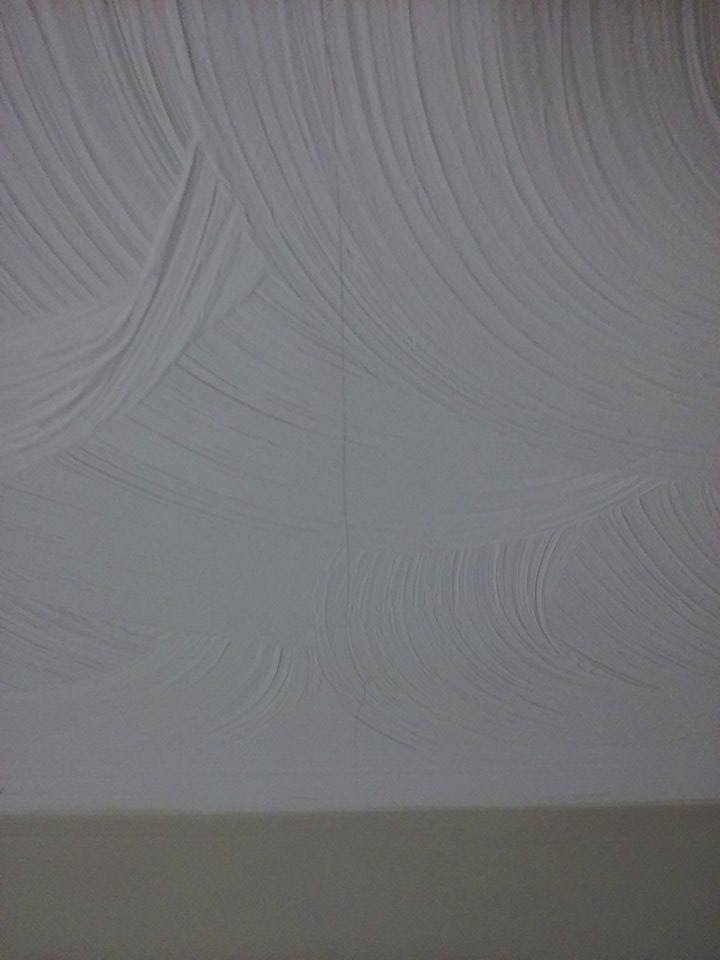

This photo was taken in a kitchen area and is of the ceiling. A couple of cracks were found. One is over the area of the door leading out to a utility room. Also is noted is an area which is showing clear sings of water intrusion. I notice also it appears paint and spackle were used in the past to cover up an area but obviously the main cause has not been corrected and the cracking and water intrusion continues.
I am reading on IR Cameras and the use of them in inspection. Going along with the structural issues theme it is apparent that water intrusion can go hand in hand with structural issues. Since I found cracks in a ceiling and signs of water intrusion one could use an IR camera to help further pin point areas of concern. On reading this article it was made clear that " In many cases, moisture or water intrusion may have been developing for a while before obvious signs become apparent." and “Leakage or moisture intrusion at one point will likely affect other areas as it moves or grows.” This makes it all the more important to address the problem quickly to avoid further complications.

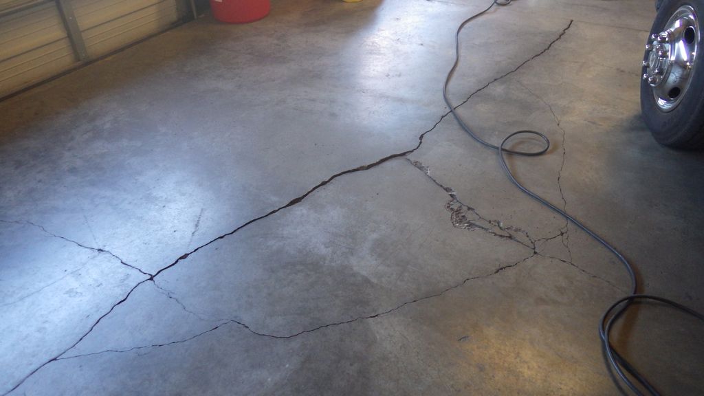

The cracking seen in the picture below exists in the bay floor of the fire station where I work. The floor is poured with approximately eighteen to twenty four inch slope from the back of the bay to the front. There are four bays and each bay is poured with a two to three inch rise between the bays, forming a trough that helps water run out of the bay. The cracks in the floor run all the way across the entire length of the bay. The cracks are the result of a combination of settling of the soil under the pads, water running down through the cracks every time the bay floor gets wet and the compression of the extremely heavy fire trucks that come and go. The cracking in the picture is the result of an eighty three thousand pound fire truck. A structural engineer will need to be consulted when repairing or replacing the floor.

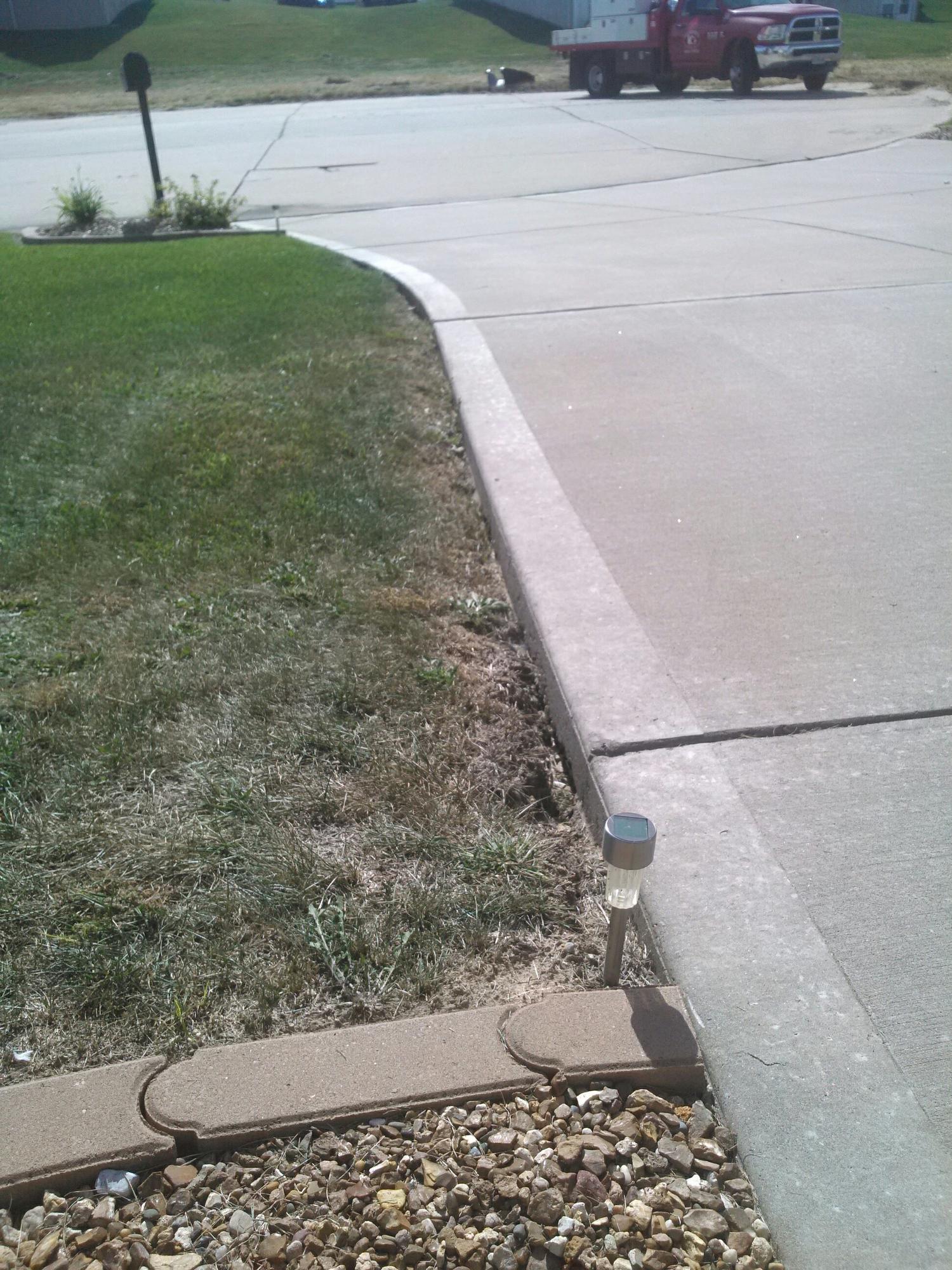

This is a photo of the dirt next to the driveway having sunk to a point that you can see under the concrete. There are no cracks in the concrete yet, but left unrepaired snow and ice will get under there and heave it up. More dirt needs to be brought in, filled and compacted to prevent a possibly expensive problem.
