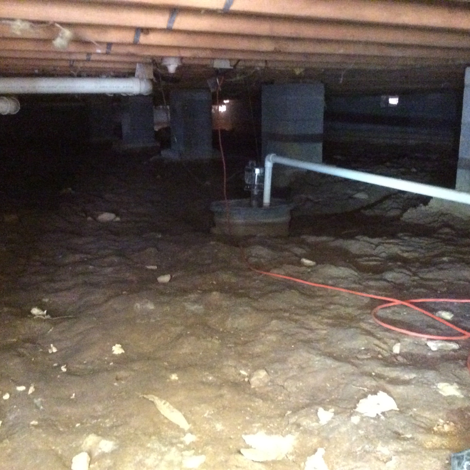

I recently inspected the crawl space of a single family home 40 year old home
The crawl space had no vapor barrier and the moisture was 17% with a hand dug sump pit in the center leftside. The ground was a sludge. I recommended a vapor barrier be put down and a larger pump be installed by a qualified professional.

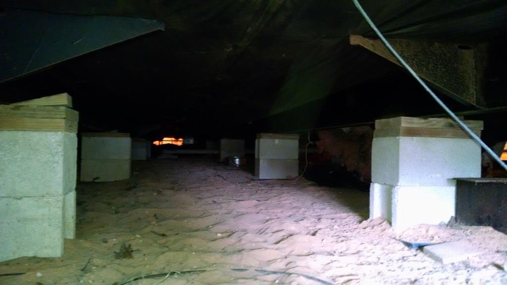

Living in Florida, there just aren’t many crawlspace homes, aside form mobile homes. So with that in mind, I found a likely candidate, and went exploring.
Florida even in winter is prime country for critters in every possible crawlspace. so I went in prepared with some bug spray, a stick, and my dog. (he wouldn’t be there on a real inspection…)
So far so good… Looks like sand and clay. Piers look good, blocks are oriented correctly, wood & shims are dry and in good shape.
and
Found some repaired water damage. Looks like the vapor barrier & insulation were removed and not replaced to make a repair to a supply line. Ground underneath was dry, as well as the insulation. Visible joists & subfloor were not rotted, and appeared to be in good shape. Informed homeowner of possible heating/cooling loss, as well as being open for critters, and to to consult a qualified repairman for repairs.

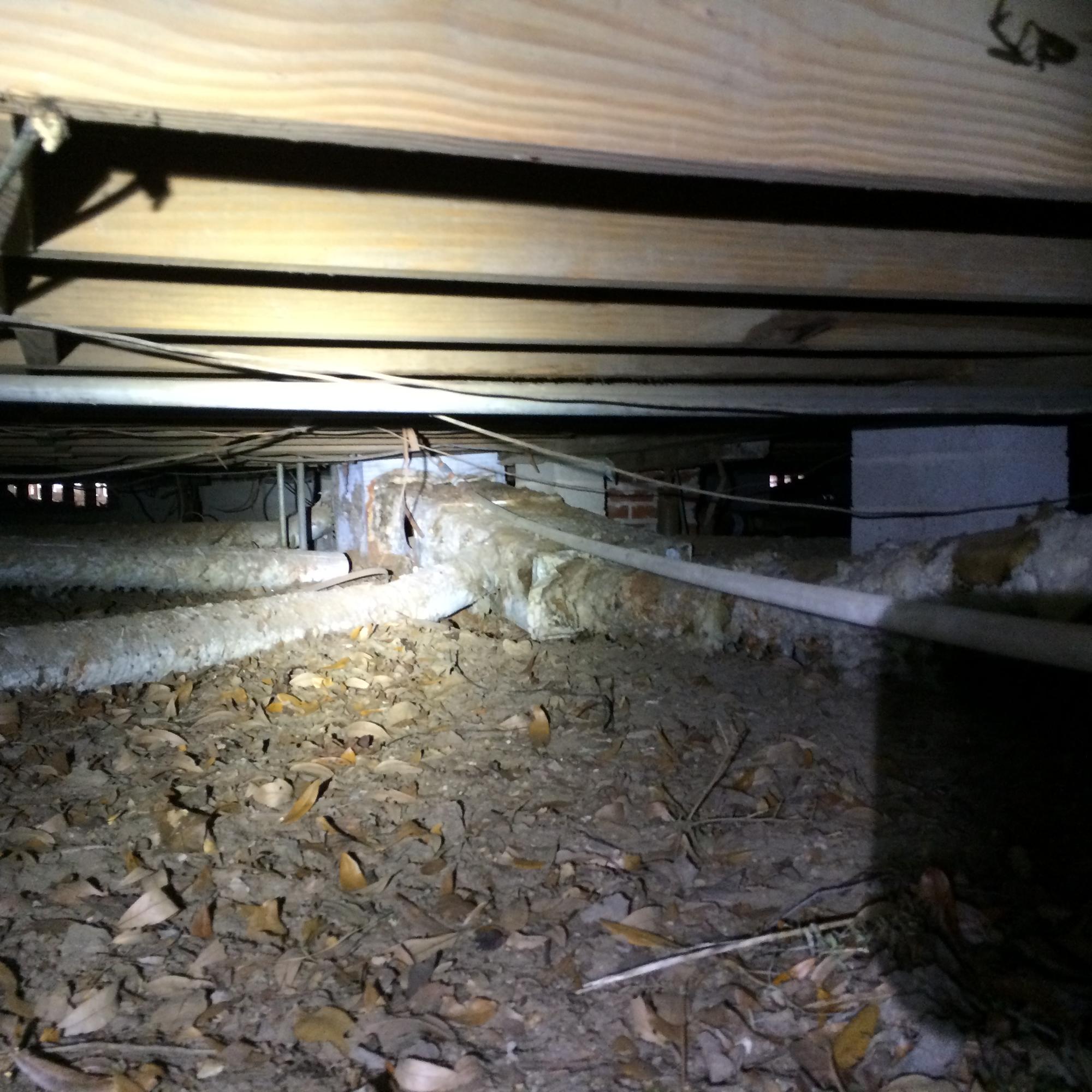

HVAC:
The HVAC ducts and plenum are not properly supported and laying on the ground.
They are also not properly sealed. Large openings are allowing conditioned air to escape.
Significant corrosion of the plenum.
Recommend repair by a licensed HVAC contractor.
Plumbing:
Water supply lines are not properly supported.
Recommend repair by a licensed Plumbing contractor.
Electrical:
Many of the branch circuit wires are hanging unsupported. Most of the wiring found was very old fabric-insulated NMC electrical wires.
Recommend further investigation and repair by a licensed Electrical contractor.
