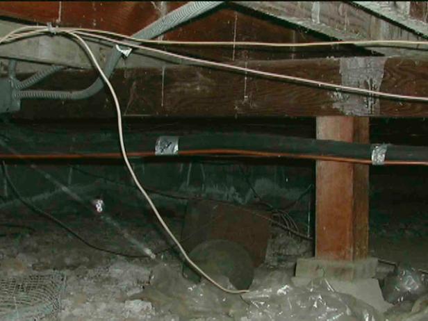

ok here is the situation :
surface : 30 feet x 24 feet
floor : dirt (irregular 2 to 8 feet of clearence)
VB : covers only half of the ground surface
Ventilation : 2 (on opposite walls) size 2 inches X 2 inches
Heat : one big a** electric heather (220) takes alot of energy to run
moisute : alot
insulation between joists (floor) : missing half of it
insulation on walls : none
Fix :
-insulate between joists
-VB everywhere (min 6 inch over laped…taped )
-insulate walls (fiberglass boards or spray foam + fire retardant)
-get rid of the big a** heater
-block the ventilation holes
-can’t really add gravel over the VB because of the irregular ground
-insulation tubing over the copper pipes
i"m i on the right track? i would think yes , but if i"m missing something pls add it up!! lolll
thx

Patrick what you have described in the original condition is deemed an unheated crawlspace. I would recommend ventilation, along with proper moisture protection. If it is really wet - I have often seen sump pits and sump pumps in the crawlspace.
If the foundation walls and header area is properly insulated, now it can be deemed a “heated” crawlspace, and that changes the ventilation requirement.
I would be cautious with insulating between the floor joists, particularly if a vapour barrier is installed on the cold side (bottom) of the floor joists, and where the insulation is provided on the perimeter foundation walls. My point being I have often found condensation collected in the cavity. Example wet insulation and wet areas in the bottom of the floor joists.
I hope this helps.
