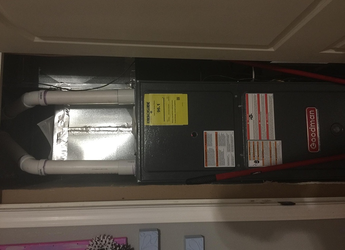

I inspected the furnace in this one. It is a good man natural gas doe flow high efficiency furnace. I can tell it is high efficiency by the exhaust is pvc and by the decal on the furnace. The filter was clean and the housing was very clean. There was a gas shut off valve right next to the furnace.

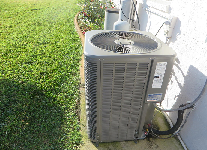

This is a photo of the outdoor heat pump, compressor, fan and condenser unit. The Unit was functioning properly. It feeds an attic installed horizontal air handling unit and evaporator. This a common central an forced air heating unit found in Florida an most south east states. because of the winter temperatures. I was able to utilize Bens advice on determining the age of the unit. I went to buildingcenter.org website looked up the unit S/N by manufacturer and was able to tell the unit was manufactured in 2005. I also recommended that the bottom of the unit should be kept clear of foliage and debris, there were a lot of fallen leaves gathered around the base of the unit.
