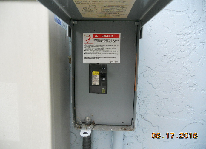

Here is an inspection I did on my AC condensing unit. The unit does have an electrical disconnect with in a few feet. The lines going into the house have been well sealed and the insulation is in good condition. The lines going to the unit are in good working condition. As you can see in the third picture the unit is in need of a cleaning. According to the http://www.buildingcenter.org/goodman website this unit was manufactured in September of 09. The unit did slope away from the house just a little and it is equipped with a Saver switch provided by Xcel.
