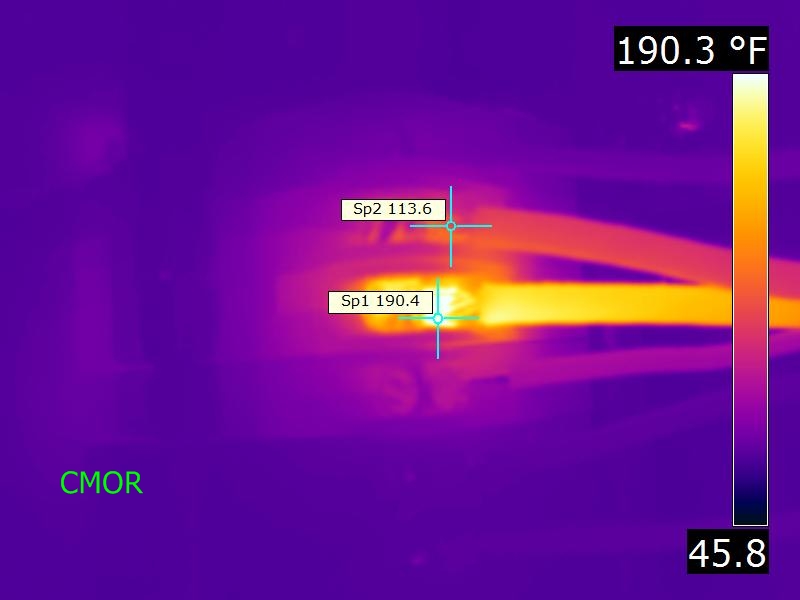

This was the third kitchen cook stove breaker this week with loose connections/ unbalanced temp between the two legs

Bob I did not say unbalanced current its unbalanced temp and yes it is the on and off of a highly used circuit that creates this loose connection out of the last 7 inspections 3 were loose

And we are not talking about ambient temp I am referencing the temp created by the loose connect. The ambient at the panel was 60 degrees give or take the connection was 190
If you like the word current Ok I like amp draw the amp draw on a cook element is balanced same amps on both legs. The only time that amps would be unbalanced is if there was a 120 circuit within the stove drawing amps such as a clock or timer ,led panel which is nothing campared to the elements
OK if that is the cause as I was wondering should you take the picture later or with a different set of elements drawing would it then show the top conductor as being a higher temp.
If all of the elements are 240 volts would it matter which ones were on or off during the test? The loose connection would always show up as the hotter of the two.
That is correct it does not matter which element is on they are all 240 volt I shoot the image while all are active before they start cycling I go for the max amps the cook stove can draw.

Are you talking loose connection point only or entire conductor as the entire length of the conductor appears to be a higher temp in the picture to me ?

My thoughts were off base apparently as I am sure the balance is on both legs under normal conditions and if there was no loose connection they would be equal temps.

The higher the amps the higher the temp. When I place the IR image in the sofware I can add or take away the cross hairs that indicate specific temps. I could place additional cross hairs on the conductor downstream from the lug/breaker connection and one can see a significant temp drop the further away from the breaker you get.

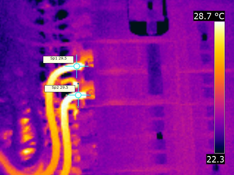

Could temperature difference at the breaker connection be caused by the downdraft and convection oven fan? They are most likely 120V which may result in a temperature difference at the legs.
Pic 390 is of the downdraft with only the burners on (exact temperature) and pic 396 is with the burners, downdraft and convection oven fan on which resulted in little temperature difference at connections. Charlie’s pic had a large temperature difference.
So, a loose connection it must be!
This oven had no convection fan and I would have taken that into considerration had one been present. Hello Marcel somehhow I knew you would mention the fan on 120 volts I just did not want to confuse BOB:D
