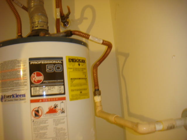

TPR material?
Is this corrugated pipe combined with the pvc ok?
I would say that is too many fittings, too many bends, too many restrictions.
Where does it discharge? Is that a garage? If so, it should go to the floor. Technically, the discharge point should be in the same room as the water heater (going through the wall is a code violation).
Except under the UPC.
PVC is not allowed, but that looks to be CPCV, which is allowed.
I’ve argued about the flex lines with a few AHJ’s. I don’t like them, but technically they’re allowed as long as they have a continuous downhill slope and no tight bends.
I would agree with Joe, however, nowhere is it written how many fittings or bends are allowed on the discharge pipe, but then common sense should prevail.
Here is food for thought… the corrugations reduce the “full size” opening of the discharge pipe. In that case, it would not be allowed in my opinion.
Bingo!
If used or allowed for water supply it is allowed for TPR drain pipe.
Local codes may be different.
I do not like lack of support or going through a wall myself.
Here are the exact codes.(Chicago )

But it’s flexible, and could whip around during release, possibly causing damage to the ©PVC piping, and potentially harming the occupants!!! :twisted:
Bob,
Those two sentences state that the pictured material is not acceptable. The flexible pipe is smaller diameter than the relief valve outlet
I agree, and that was my position as well. However, I have been trumped by local officials.
95% of the homes in this area discharge through the wall. Must be a location thing.

Nowhere, in the IRC is it mentioned how many fittings or bends are allowed on the discharge pipe.
However, the TRP Valve manufacturers will often times have their own rules and will say the discharge pipe shouldn’t be more than 30’ and should not have more than 4 elbows as this could cause restrictions and reduce discharge capacity of the TPR.

I Agree with what you are saying and there is a need for the rule to a point.
Pretty much std practice to pipe them through the wall in the greater Houston market, especially on new construction. Not arguing the IRC reference, but accepted by all AHJs that I know of here.
