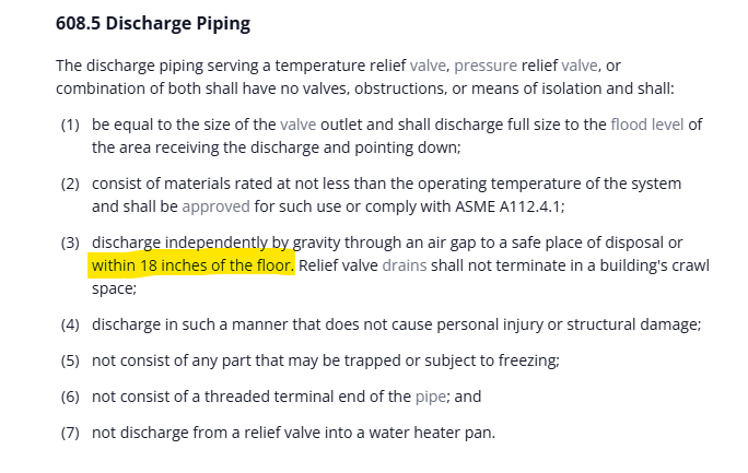

Yeah, it can be cut. In my state, we allow up to 18” from the floor to the bottom of the pipe. Check your state code to see what the max distance to the floor is.

It varies by state or municipality.
Here is GA 2024. Bold are mine.
504.6 Requirements for Discharge Piping
The discharge piping serving a pressure relief valve, temperature relief valve or combination thereof shall:

  8. Terminate not more than 6 inches (152 mm) above and not less than two times the discharge pipe diameter above the floor or flood level rim of the waste receptor.

Where do you live where this is okay? Should never be more than 6” from the floor.
My location is in my signature, but it’s Minnesnowta. I don’t know why they allow the 18” but most plumbers go with 12” to 18” as far as I’ve seen. Can’t say 18” adds much risk over 6” though.
This is definitely a case of you need to know your local plumbing codes, not what someone says is fine or not fine for their own state.
