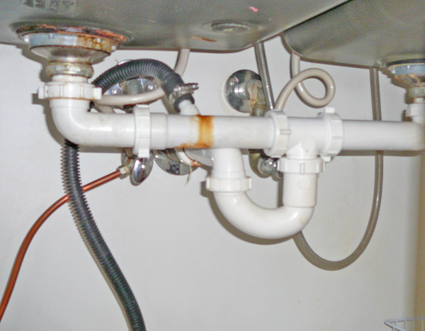

Trap help
I am not guessing at anything. If my nose fails to smell anything untoward it is not likely spilling gasses.
If this is in a new house I would report it. If it is in a century home or 50 year old home it was standard at the time.
Downspout extension could hardly be described as life safety, but yes I would report it as basement leaks could be a result and evidence suggests basements are one of the most common complaints or law suits.
Its not a code violation if its existing and predates the current code. It is not a requirement of the code to upgrade unless renovations are planned. There are many existing older structures with S traps that function fine. To suggest they are all code issues or issues that must be remedied is a misnomer, each case maybe different and that is what should be factored in.
Besides the SOP indicate its going beyond the SOP the way I interpret it.
Just because it does’nt smell when you’re there doesn’t mean that is without problems.
They changed the code for a reason.
But if you saw no other evidence,Why?
Trouble is, you don’t know which ones. You’re not livingthere.
So overlarge spindle gaps or short railings wouldn’t be reported by you either?

Substantiate your theory that existing systems must be updated to code please.
I never indicated that in any way.
Informing my clients of potential issues is my responsibility.
You of course may do as you wish and incur the liability that goes with it.
I do not site code BTW.
I inform my clients of potential concerns, but I don’t make an issue of something that met code at time of construction.
One thing I noticed about people posting questions on this board is they fail to mention age which is a concern in some instances with what is or was permitted and is still permissable. As with this case the postee has not mentioned the age of the structure which will affect the replies.
When renovations are done, all upgrades must be code compliant. If the pipe is ABS plastic, the code was in effect at the time of installation.
True, the code was in effect many years before ABS pipe was ever heard of.
Would you call that an “S” trap, it goes into the back wall, not through the floor?
Its an S trap because the trap arm dose not enter a sanitary ell- it enters a second sweeping ell.
You can call it an “S” trap or just an improper trap.
The horizontal runs and pipe sizes do not qualify it to be a “vertical leg” waste drain.

I find this type of trap configuration quite a bit.
I always call them out and advise the client of the potential problem.
A cheap solution is to run a bit of water into the sink if they detect a smell or have a plumber install a cheater vent.
hope this helps
By some of the logic above, I need not be concerned about a improperly installed vent pipe from a gas appliance unless I observe the appliance back-drafting at the time of inspection.
I’m not sure what “logic” you’re referring to, but your conclusion is wrong. An improperly installed gas-appliance vent can be a significant safety hazard even if you don’t observe any back drafting.

Meanwhile, this morning’s drain plumbing: dishwasher connected to DW tailpiece adapter employed as part of a horizontal run to a center outlet waste tee above the trap inlet. Is there a specific prohibition against using this tailpiece in this manner?

I don’t have my references with me (I’m on the beach :)) but fittings are to be used in the manner for which they are designed/listed.
