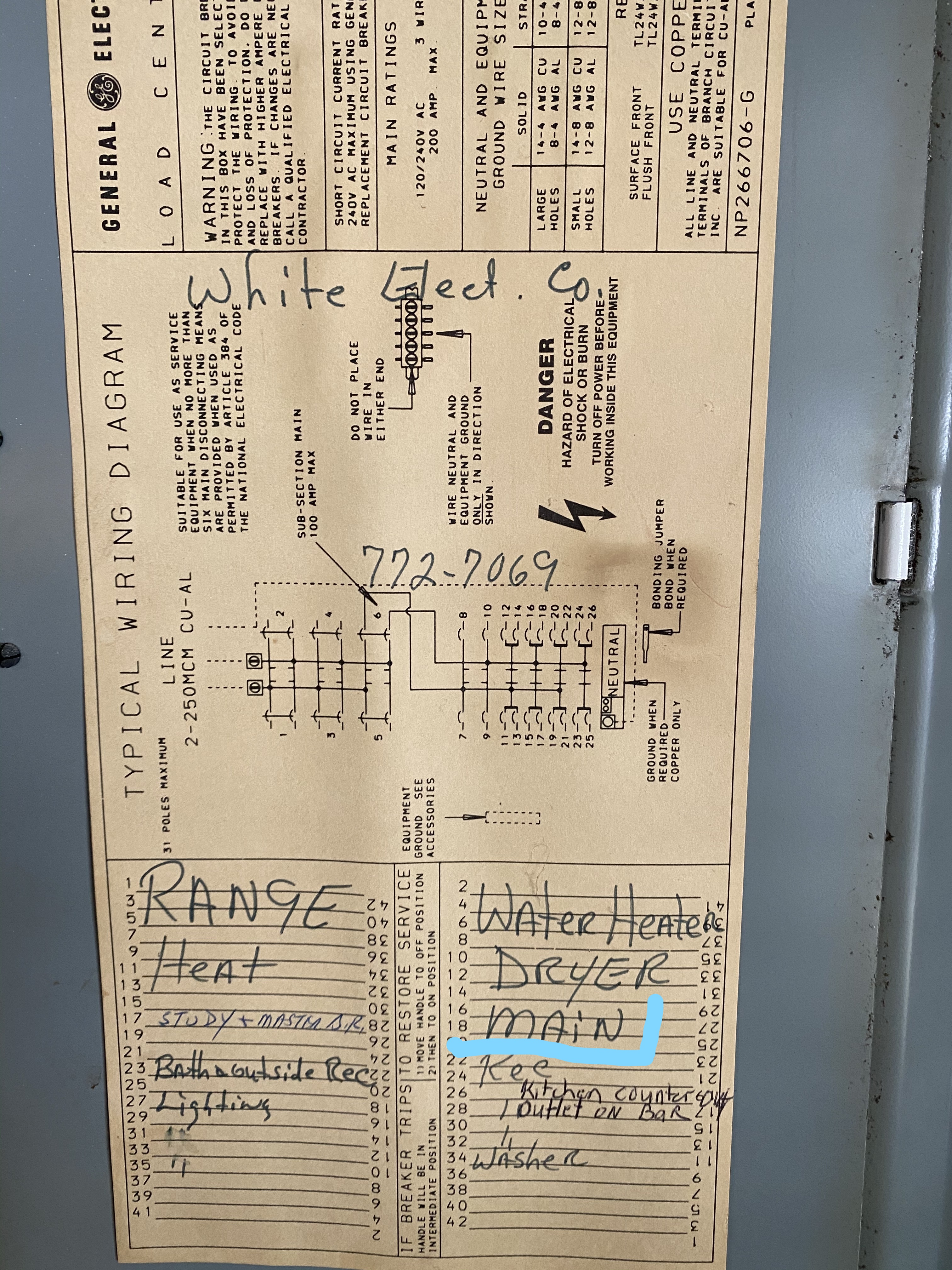

That’s the simple answer. The label on this panel cover provides all of the pertinent information.
There is a main disconnect. And usually it is at the meter.
There wouldn’t be one outside with this split-bus panel board here, Kurt.
I agree especially since it’s only 3-wire SEU cable from the outside.
