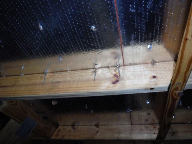

A roof deck nailed in accordance with the FBC would not have any shiners…this is where things get a little technical. If you’ll (generally speaking) accept an Engineer’s approval for a glazing why not a Licensed Roofing Contractor’s affidavit for re-nailing?
The form, it it’s current wording, isn’t realistic. A roof deck with shiners is improperly nailed and in violation of the FBC, so how do you properly determine re-nailing? I don’t know what to tell you…
You live in a fantasy world. We need at least one shiner to prove the nail size. If not for that it would be something else for you to ***** about.
So you are saying that they must void the FBC so you can find a nail for them to get a credit. What happened to using the infamous MT6?
It’s not the actual shiner that is a code violation, it’s the assumption that the decking is not nailed to current code. If the shiner is backed up with another nail into the truss, then it’s FBC compliant. Re-nailing is a different animal than new construction. The shiners are never pulled on a renail, even if backed up. There is also an assumed percentage of allowed misses, taking into account that the deck was previously nailed off originally, and 8d (ring-shank) is required for the renail. This may not be spelled out in the code, but it is widely accepted by AHJ.
As far as the roofer’s affidavit goes…Roofers lie on those all the time and the insurance carriers know this. They are usually not accepted as verification of RDA.
You are wrong.
On the roof pictured, which was involved in a lawsuit due to the improper installation of virtually every component of the re-roof, the city of Tamarac code official made the roofer remove every single missed nail. I have spoken with the code officials in Coral Springs, Fort Lauderdale, Hollywood, Pembroke Pines, Miramar, Pompano, Coconut Creek, and numerous others and every one of them said the same thing. “Remove the missed nails and try again”! There is no such thing as an “assumed percentage of allowed misses” located in any roof deck nailing guidelines or the building code.
To assume that the moron that couldn’t follow the original nails and nail in between them, could somehow have the wherewithal to re-nail where he didn’t even know he missed, is perhaps one of the most asinine statements I have ever heard. And in the end, it is still wrong.
I have abstained from this message board due to BS just like you posted. It is mis-information like this that is going to eventually cause someone to end up in court. And from what I hear, that is going to be sooner rather than later. And when they trot out the “It’s accepted practice to miss the trusses defense”, they will get laughed out of court. And those that subscribe to this nonsense will end up paying.

Eric, I thought you might comment on this. Seems to be a pet peeve for you. I do agree that if the entire roof was missed then it’s time for a redo. I have been framing for a long time and I can tell you that I am not wrong. You have to come back to earth and accept that roofers are not perfect and will miss a few nails. AHJ never inspects the attic space on re-roof (that I know of). Most of them accepts the roofers word that it was renailed via affidavit. I am speaking of personal experience and real world scenarios which we inspectors have to take into account. If you think that I will fail a renail for a few misses, you are mistaken.
It is a pet peeve for me as it is wrong. Plain and simple. As for real world experience, see the previous pictures. There are plenty more on the roof page on my website. All of those roofs had to be replaced. The problem is that many are afraid to call this issue out.

If you miss, pull it out and re-nail it correctly…it’s not rocket science…

Robert, have you ever used a pneu nail gun with 8p ring-shank? How much damage would you have to do to the sheathing and how long would it take for you to pull a ‘missed’ nail? In your likely inexperienced world, trusses and rafters are installed perfectly plumb and square. They are never ‘floppy’, despite being just 2x’s. No, they are perfectly rigid.
And EVDV, your advice to ‘just follow the other nails’ is not realistic, either. So, just follow other ‘misses’. And, really, Brad is right. No muni inspector is going to go in the attic on a re-roof permit to look for ‘shiners’. What a ludicrous concept, and also, who TF cares? Let’s damage the sheathing for no good purpose.

I have yet to find a house without “shiners”. The attached picture is from a house I inspected earlier in the week that was built in 2010. So according to your logic, every house I have inspected is a violation of FBC, that is absurd.

Now, show me where it says miss as many nails as you want, assumed percentage of allowed misses, or anything else that some keep bringing up.
You can’t…because it doesn’t exist.
And to be clear, I am not referring to one or two nails missed, although technically wrong. I am referring to mass misses as pictured.
