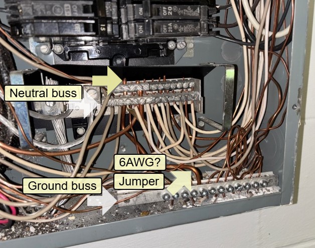

Unsecured ground bus bar
In a typical house system where there is a green screw as the main bonding jumper the GEC is not connected to the EGC bus it gets connected to the neutral. If there is only a single neutral bus then the EGC’s can terminate there as well. Grounding electrodes are not needed or provided to clear ground faults.

Here is what I see so far. The ground/ing buss is possibly bonded with a very questionable jumper.
The jumper should be 6awg coper if I am not mistaken. Does not look like a GE manufactured jumper.
Floating Ground buss.

![GE panel bonding jumper disconnect|622x485]
The egc between the buses would only need to be sized for the largest circuit it was serving.
i can’t because i didn’t look closely, but it has been discussed on up the thread and determined that it is bonded, connected with a jumper, whatever, and electrically will work. questionable installation points to possible other questionable work also. i believe it was yourself that posited that.
One assessment would be, assumed the panel was bonded. That panel has issues period. Bonding is not assumed, but tested.
you’re absolutely right about that, and since you mentioned it i looked closer. you’re probably old enough to recall those old prego commercials, and it’s just like they said: “it’s in there”. notice the copper wire going from that bar to the other one, the one that is connected to the box. bonded, not assumed, but pictured. unless i am mistaken in my terminology, it happens so it’s possible. have a great day.
