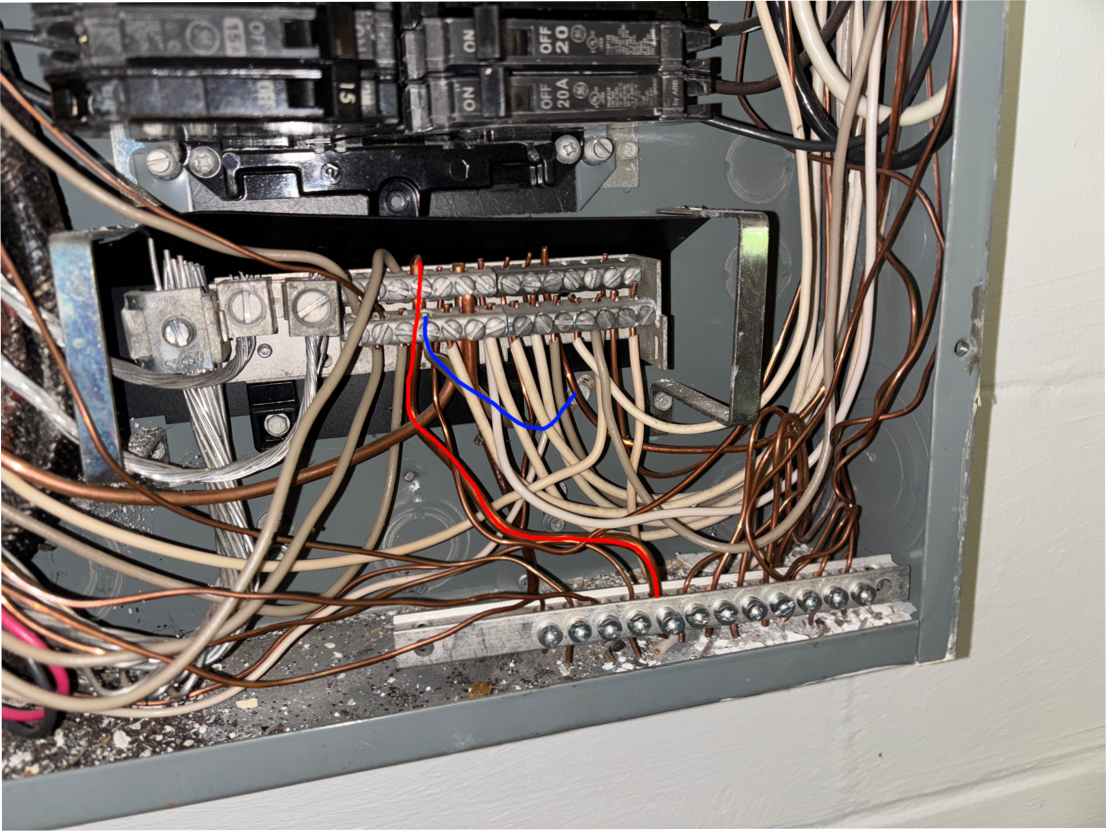

Unsecured ground bus bar
Inspection today, 1978, 200 Amp, GE main panel in the basement. The ground bus bar is free-floating, but it’s connected to the neutral bus bar with a jumper. My initial inclination is that it’s correct, but, the bar needs to be secured. Am I way off base on this? Does it need to be secured/bonded to the panel?
Looks sloppy and yes the panel should be bonded to the grounds. Did you check for a bond? Wiggy leads between a hot terminal and the panel will verify a bond (it would be easier if there was a visible screw). Is the neutral bus bonded to the panel?
And…the neutral bus is connected to the panel with a strap and screw…so technically its all connected. Should the ground bus bar be secured…yes…but with the cover closed, whats really going to happen to the grounding bus bar? I can’t really think of anything right now.
As long as the enclosure is bonded somehow, and the loose bus is tied to the neutral bus, there isn’t a huge problem here. But, it would go in my report as a “sub-standard installation method.”
The additonal EGC bus is required to be connected directly to the enclosure due to the instructions included as part of its listing. It is bonded to the neutral via the bonding jumper so electrically it will work but the installation is not code compliant.

It will work electrically, but as has been pointed out, technically it doesn’t meet code. One potential issue would be difficulty in removing or adding a conductor to the bus.
Surely Robert Young 15 year Certified Master Inspector isn’t making things up…again…right? :thinking:
Exactly. Electrically the floating bus is nothing more than a big wirenut with a pigtail to the neutral bus which is permitted for EGC’s so there is no hazard as long as the pigtail is properly sized. The code violation issue with it laying in the panel is something else.

If you think about it the path for fault current is not to the earth. The earth is relatively poor conductor and is not permitted to be relied upon for clearing a fault therefore the earth connection of the system has no bearing on clearing a ground fault. A ground fault is cleared because the EGC is connected directly to the neutral via the MBJ (green screw) in the service panel.

The first statement is correct but that path is not through the earth, it is accomplished by the connection to the system neutral. On your second point yes this panel shows obvious signs of poor installation practices which may indicate that there are other problems.
