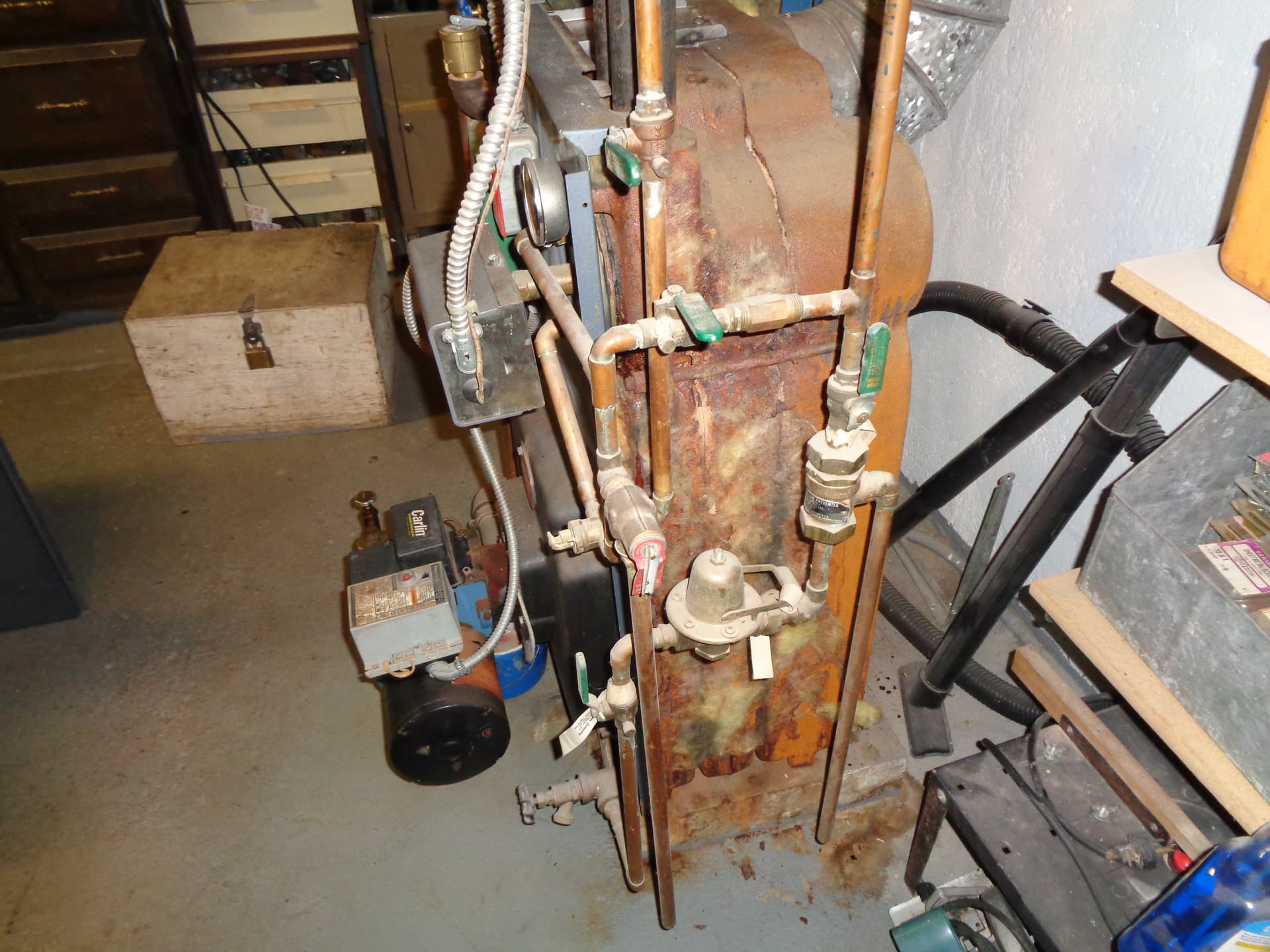

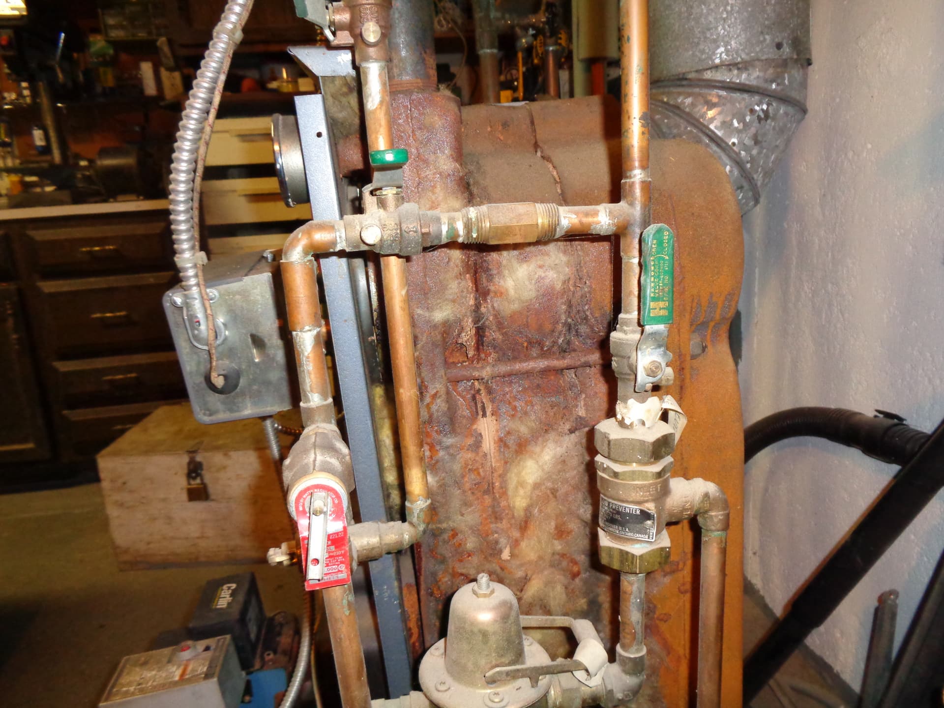

I saw water dripping on the floor so I took the jacketing off to see what is going on. Yup, leaking. Called my Heating guy and he will get me a new boiler. When the air hit it well, it stopped leaking, but that won’t last for long.
This is a Weil Mclain boiler 31 years it lasted. Had it cleaned every year.
Time for a new one before winter. Hope it last two weeks before I get another one.

Old Weil Mclain cast iron boiler is rusted out.
31 years is not excessively old Marcel.
Leaked many times.
Almost all ball valves are in the closed position. Was the boiler operating?
Weil Mclain are a good boiler manufacturer. Never ran into that model.
No, it wasn’t Simon. boiler temp set at 160 and 180. When they are cold or shut off they would leak at the gasket, but this was not the case. Cast iron can seal itself up temporarily, but not always the case.
That’s because of the domestic hot water storage tank conversion on the other side you can’t see.
