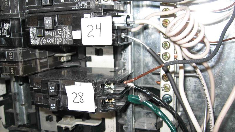

What electrical concerns/defects do you see?
#24 - you’ve got aluminum branch wiring with an insulation jacket cut back to far.

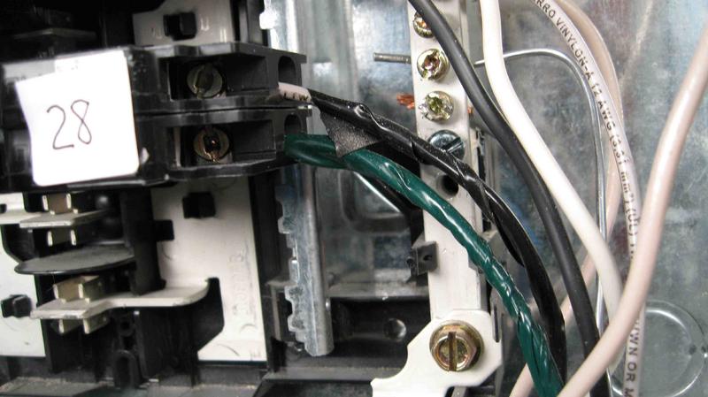

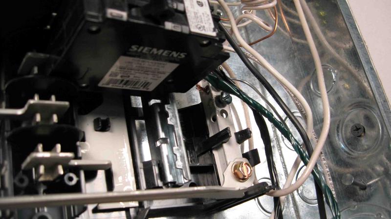

#28 you’ve got issues with taped wiring and one branch wire hanging around in picture #1 but it was removed in picture #3.
Why the green and black tape?
And I also notice some exposed panel hardware not fully secured and one is utilizing a knockout.

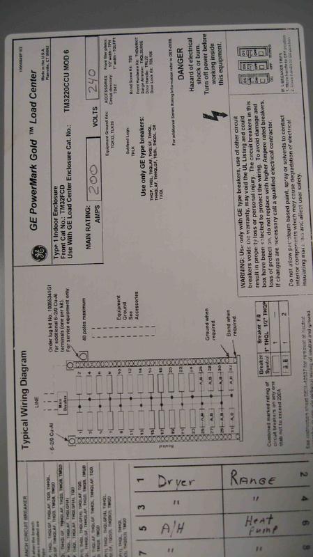

There is a Siemens breaker when the label says use GE breakers only.
Bonding screw loose.
Drywall screw and loose nail used to attach panel board.
On pic 1, looks like there are AL and CU conductors secured together under the same terminal screw. ?
Thanks,
Linda, I believe the CU conductor is just flapping in the breeze. ![]()

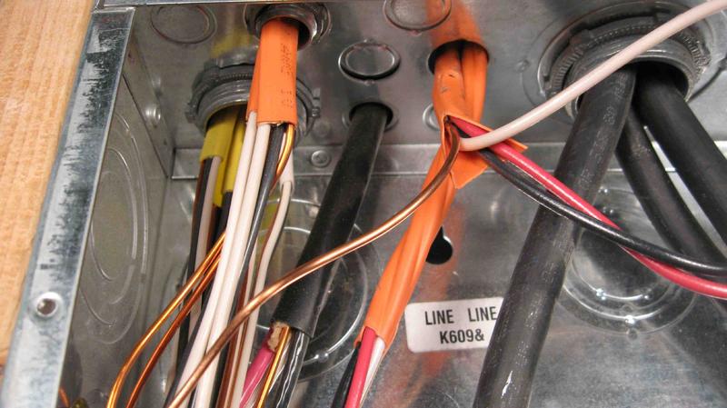

What concerns/defects do you observe in this picture?
I see two.
Electrical Panel Game. Free. Online.
It looks like the SEC has been trimmed as well. . .
Missing bushings, but I don’t call out the “excessive” sheathing. . .
