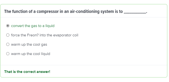

I learned that the funciton of a compressor in a heat pump system is to compress the gas, into compressed gas, not liquid. Actually, I was very specifically advised that the gas does not become liquid until it is condensed. So, this NACHI question is confusing:
You are trying to convert low temperature, low pressure gas to high temperature, high pressure gas. So it is part of the process which makes it a correct answer.
You are correct that a compressor should not and can not pump a liquid. It will destroy it eventually.

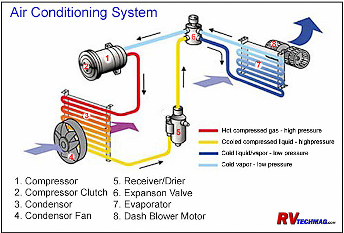

It does force Freon (improper terminology) into the evap coil, before the metering device. The metering device causes a huge pressure drop which causes it to flash off and cool the liquid refrigerant which enters the evaporator as a cooled liquid where it absorbs heat from the air and turns to a vapor. Back to the compressor to be compressed.

Yes, to a gas, not to a liquid. The answer states “liquid” even though it’s not liquid. So what is it that makes it a correct answer?
If this is the only correct answer then why is it not the best answer? All the other options are clearly incorrect.

It is not the best answer, BUT it is the best answer GIVEN.
I don’t want to belabor the point but the gist of my question is if the best answer given can be a wrong answer?
It seems to me that in this case it is not simply the best of the bad answers, it’s simply wrong. So how can a statement that is wrong be the best answer? Or is it possible I’m missing something? Is it possible that the compressor does in fact convert gas to liquid? That would be very insightful for me to lean that.
Or, maybe I need to apply occam’s razor? Maybe the question used compressor when it was supposed to be condenser?
The answer is not “simply wrong.” Compression is part of the condensation process of refrigerants. Water will condense at atmospheric pressures because liquid is its natural state (at most of the earth’s temperatures). Refrigerants natural state at atmospheric pressures is a gas.
In order to condense into a liquid (for nominal heat transfer) it must be compressed. I believe one of the posts already pointed this out. It is a required part of the process…

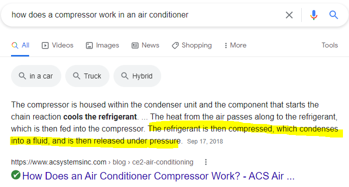

I have a sense that you are getting very close to untangling this for me but I’m still confused about how it can be stated as true that a compressor converts gas to a liquid. I can’t find anything that supports that notion. Everything I’ve read contradicts that statement. I’ve read that the compressor actually heats up the gas which further activates the molecules which by definition makes them more gaseous, not more liquid, even if they are made liquid at some other point in the process. It doesn’t seem to be true that it’s the compressor that makes them liquid. Is this just one of those things we accept as true because it makes it easier to explain even if it’s not actually true?
I’m not sure what your confusion is. Without compression there is no condensation of a refrigerant. You can bicker all you like about the accuracy of the answer required, but it is the best answer given and for a rudimentary explanation of the process works just fine. Total comprehension of the physics involved is not needed nor are you being tested at an advanced level.

What do you mean by “look it up” when I’ve stated clearly that I have looked it up. I spent a ton of time investigating every question I’ve posted and in this case I have found more references to say a compressor does not and can not convert gas into liquid than I have to say it does or even can convert gas to a liquid. I know that the gas is converted to a liquid in the process but is it the compressor that does it? I don’t think so but I’ll investigate that reference you posted. I’m here to learn but learning is not the same as blind acceptance of whatever someone tells me even if they are smarter than me.

Ok, semantics. The conversion happens in the condenser, but the pressure comes from the compressor.
So, what makes it happen?
Yes, that’s why I posted the question. I think the statement should read condenser, not compressor. But I can understand why the answer to this question would be more obvious to people who have more experience with split systems. To all of you it’s just semantics, but to me I’m really digging in deep to understand it all and that’s what makes this question tough to swallow.

Funny thing about a ‘compressor’ is it’s just a pump. The compression occurs when it pumps into a restricted space. Anyone who’s ever rebuilt an air compressor knows this. We can also pump water the same way AND raise its pressure. My pressure washer does just that. The key to understanding an air conditioning system or heat pump is getting a handle on temperature - pressure relationships.
