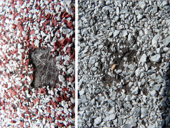

What's wrong - if anything - with these shingles
I’ve not seen this particular issue before. Most of the shingles on this home are pitted, however, I saw neither asphalt (usually jet black,) nor fiberglass readily visible anywhere. The realtor claims these are impact resistant shingles.
Aside from a few shingles with apparent hail damage, I’m not sure what to say about these. They are not smooth, and appear to be pitted.
(The buyers realtor says the sellers claim to have had the insurance company come out to inspect for hail after a storm last summer, and that the adjuster said, no damage, no need to replace, and that these are impact resistant shingles).
Any help would be much appreciated.
You just said it, Joe… and maybe add; “recommend a qualified roofing contractor assess the damage and quote pricing, if any, to remedy if needed. The buyers realtor says the sellers claim to have had the insurance company come out to inspect for hail after a storm last summer, and that the adjuster said, no damage, no need to replace, and that these are impact resistant shingles.”
Pass it off the a qualified roofing contractor and be done with it. :smile:

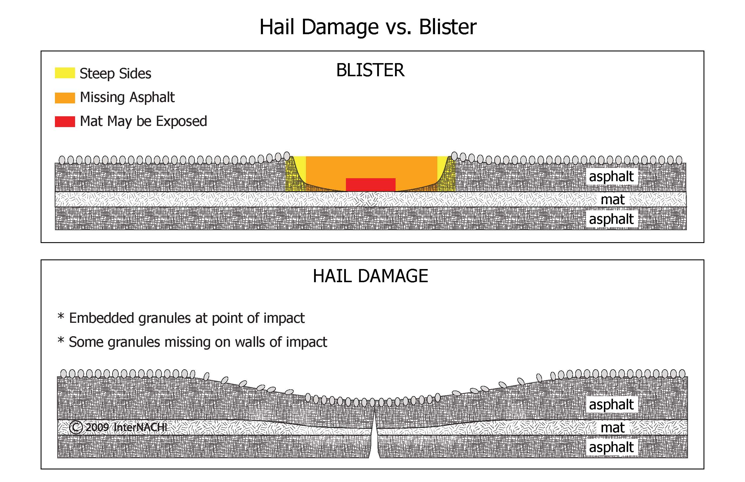

Pitting due to blistering.
Did you go into the attic? was there proper ventilation?
Attic had blown insulation. I inspected only from the hatch. The soffits had vent covers - it’s possible the blown in insulation covered the vents. It did appear that the roof could stand to have more venting near the ridge.
How old is the roof? Could be pre-mature failure due to manufacture defect and possibly covered under warranty.

Observation: Mineral/granular loss due to mechanical damage. Suspect hail damage.
Recommend: 1: A licensed roofing contractor access and perform a roof tune up in the spring, weather permitting.

Yep that’s it. Not functional damage. An insurance claim based on this condition alone will be denied.
Blister on the left, Hail on the right
