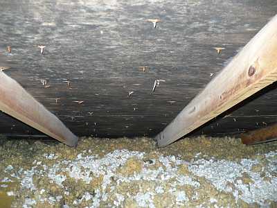

On Thursday, I was in an attic with the north side of the roof sheathing covered in black mold-like growth. The south side was only partially covered (suspect the Sun had something to do with that). The attic had completely blocked soffits, bathroom fans terminated into the attic, and condensation evidence was on the single window there. I thought worse case, it was Strachybotrys chartarum, “black mold”. From my understanding, the spores are typically not ‘very’ air borne unless disturbed. So I spoke with the client, and explained what we were possible looking at, since he had no clue.
I messed up. There was a ridge vent in the attic, and it was windy & cold. The open attic hatch was pouring warm air into the attic. It was hitting the mold-like growth, so it was being disturbed, big time. :frowning:
Mold is greatly underestimated, and for the cost of one small mold inspection, or in this case a home inspection, can result in fewer sick days, or even worse.

Are you environmentally sensitive, allergic, immune system compromised on a regular or continual basis?
I was at a home inspection meeting many years ago and heard about a home inspector who became exceptionally ill and was off works for many months from going into an attic with no breathing protection.
I went out the next day and bought a good Mask ($49;00) .
Had an Inspection that afternoon and was on my way into attic and Char reminded me to put on my new mask.
Well I think she might have save me from being like the inspector who was of work for many months.
Bat Dung and Bats Lots of both
Bat dung can cause ( histoplasmosis ) that was what the HI was of work from.
I never go into any attic with out my mask.
