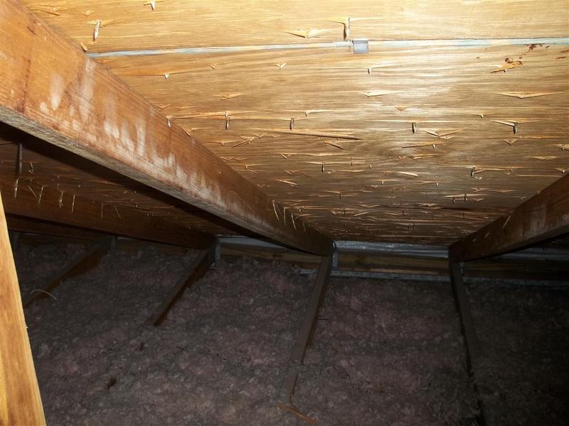

At this point the poor guy must be confused, dismayed and disgusted if he expected a straight answer. I apologize, when dealing with this crap be prepared to be confused, dismayed and disgusted. I know I am.
This is the EXACT purpose of the questions.
John or Preston any input?
neef fl# or dade noa#
There is not enough information.
“X” or “N”
I think we can all agree that without any documentation or labeling, we will be forced to mark X or N.
Here is another question, how do you mark this for the nailing pattern?
Here is another prime example why it is difficult to check someones work without going behind them. There is really not enough information. It could be C or it could be other.
They missed every single truss.

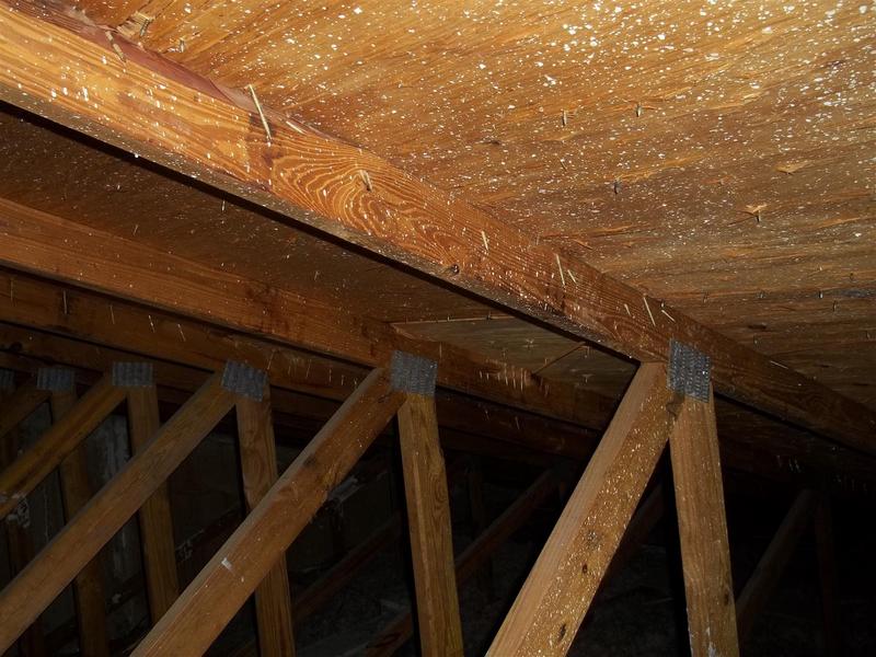

Here is a little more information for you John: :cool:
I think that they need to have that glued down. I’d have to mark other. What did you do?
This was a home inspection and I haven’t done the wind mit yet, and probably won’t, as this was a townhouse and the association is responsible for the roof.
I do a wind mit on every home I inspect for practice and in the event they need one, it is already done.
If I did do a wind mit, it would be other. As it is, the recommendation on the home inspection was to have the code official either review the pictures or actually come out and look in the attic and make a determination as to what should be done.
This will more than likely create a big problem for the association as the roofs were put on at the same time and I am sure there are other units in the development that have this same issue.
I have spoken to four different code officials and all said that the missed nails have to be removed. That means that the roofs are going to have to be removed. I expect phone calls later on today…
