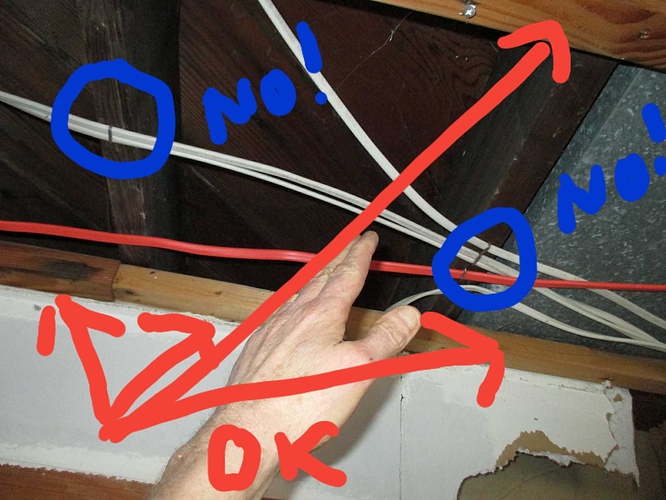

Wires run under joists of high basement ceiling
Not ok as in the OP.
If the NM is on the board behind is hand it is not running “with joists”.
PS. The NM could also be on the board in the upper right corner of the picture. For those who are learni g the code.

Sorry, alongside the joist the cable doesn’t get used for clothes hangers. Across the joists as shown it can be used to hang things from.

Not ok. Too close to the nailing surface. Lacks the required minimum 1.25" setback or nailplate.

© In Unfinished Basements and Crawl Spaces. Where cable is run at angles with joists in unfinished basements, it shall be permissible to secure cables not smaller than two 6 AWG or three 8 AWG conductors directly to the lower edges of the joists.
Smaller cables shall be run either through bored holes in joists or on running boards. Nonmetallic-sheathed cable installed on the wall of an unfinished basement shall be permitted to be installed in a listed conduit or tubing or shall be protected in accordance with 300.4. Conduit or tubing shall be provided with a suitable insulating bushing or adapter at the point the cable enters the raceway. The sheath of the nonmetallic-sheathed cable shall extend through the conduit or tubing and into the outlet or device box not less than 6 mm (1∕4 in.). The cable shall be secured within 300 mm (12 in.) of the point where the cable enters the conduit or tubing. Metal conduit, tubing, and metal outlet boxes shall be connected to an equipment grounding conductor complying with the provisions of 250.86 and 250.148.
